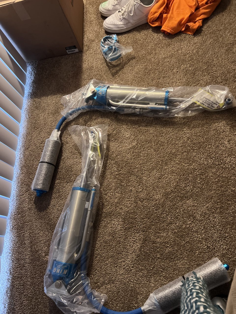

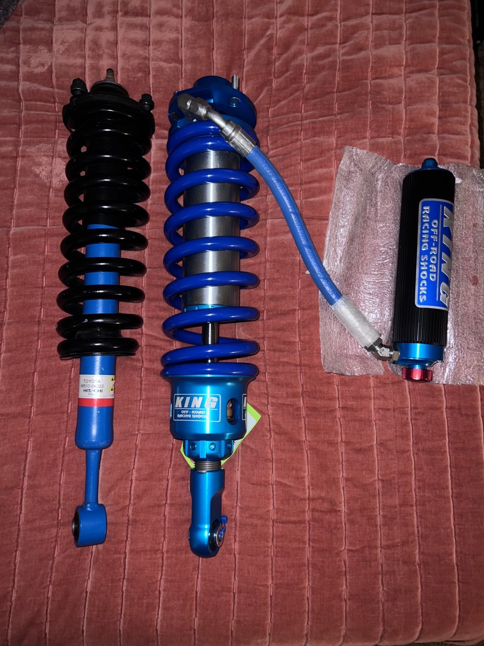

    Totoya4x4
    Totoya4x4 [OP] Member
    Nov 4, 2021
    #381317
    24
    2022 Tacoma TRD Sport DCLB, 3.0 King Off-Road Racing Shocks, ICON AAL, Element UCA’s

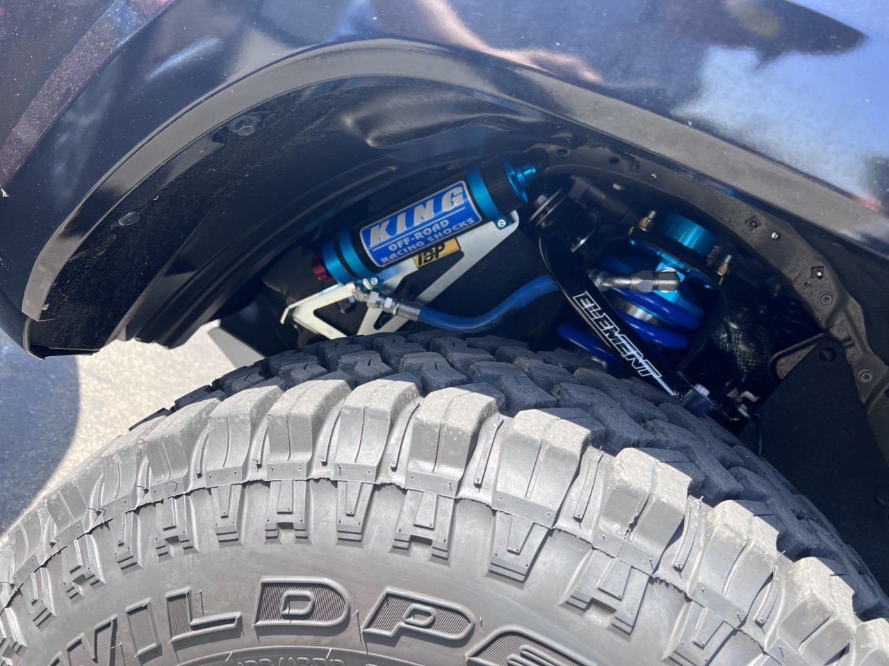

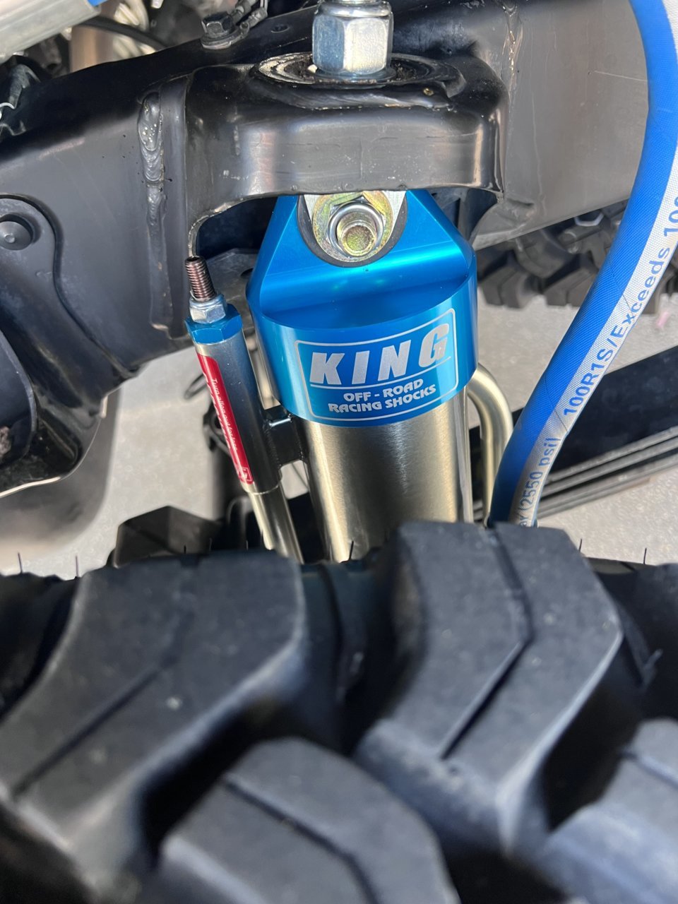

    Alright guys me and the taco have a date set. June 3rd, 2023 the King 3.0s will be going in. Here are some pics of the shocks. Check back with you guys in a few weeks.

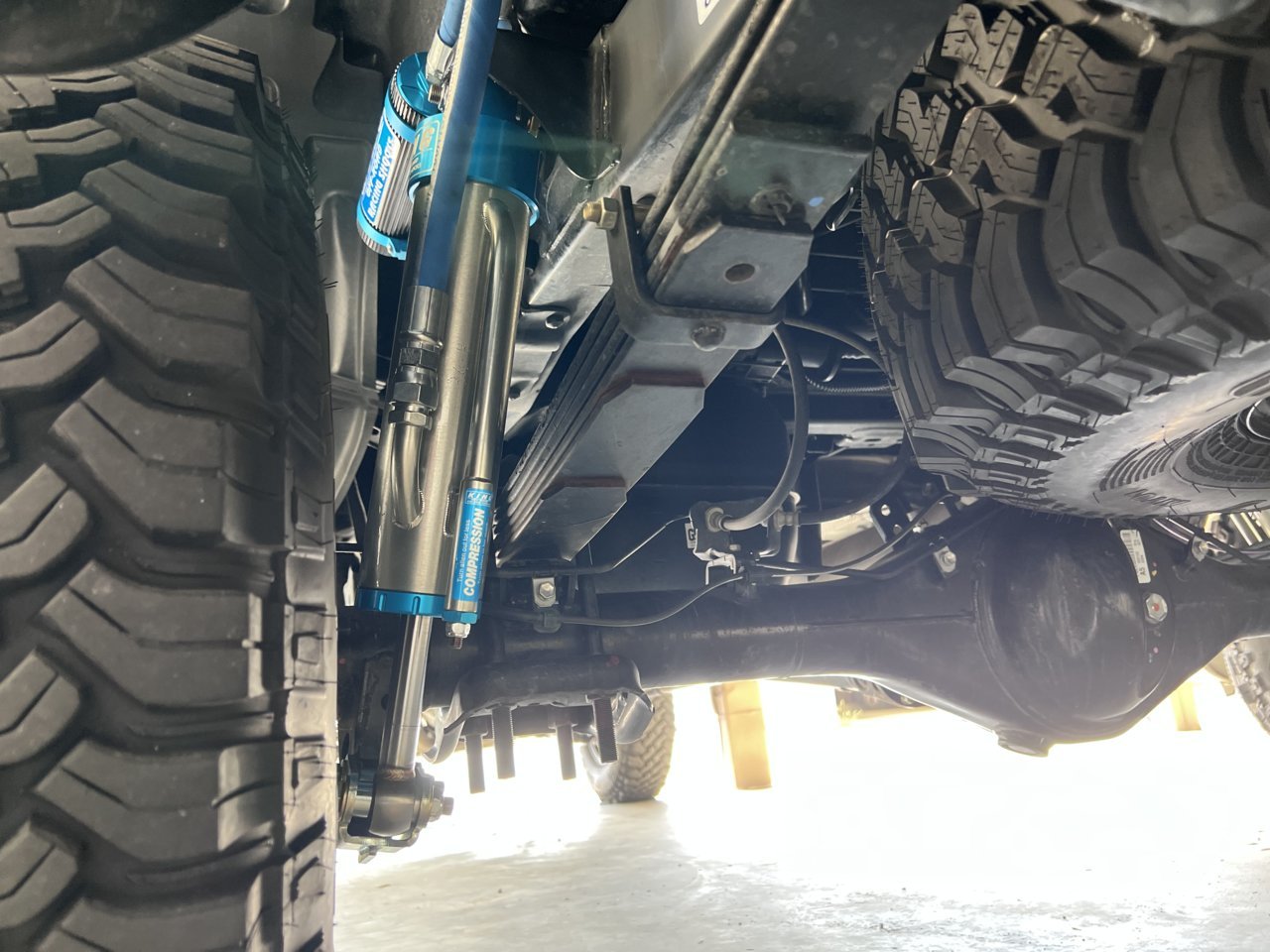

    Nice! I wonder what the additional brackets on the top and bottom of the rear shocks are?

    its just to adapt the eyelet style mount to the stud mount since they dont have a proprietary top cap for the 3" body shocks

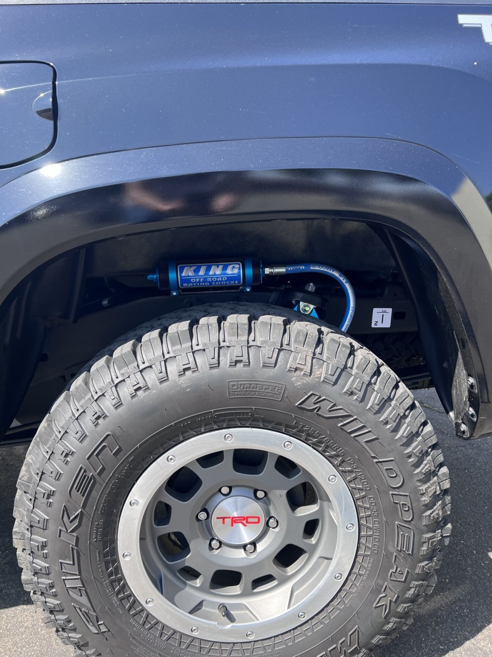

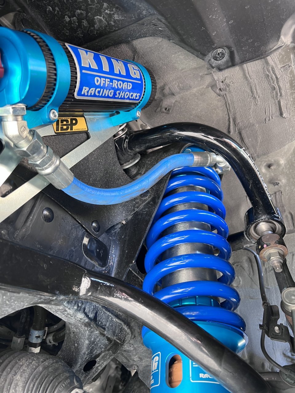

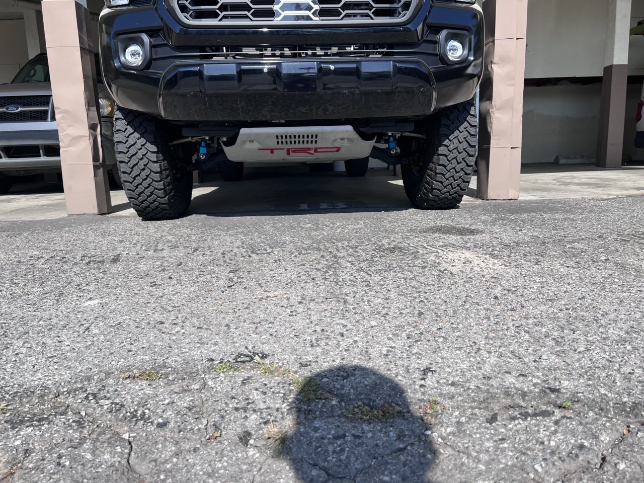

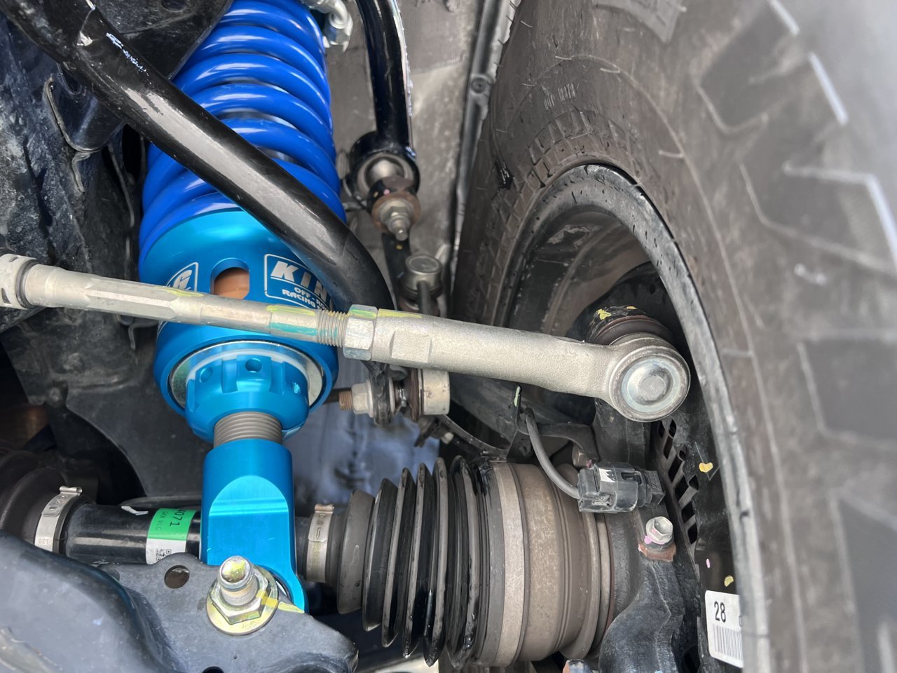

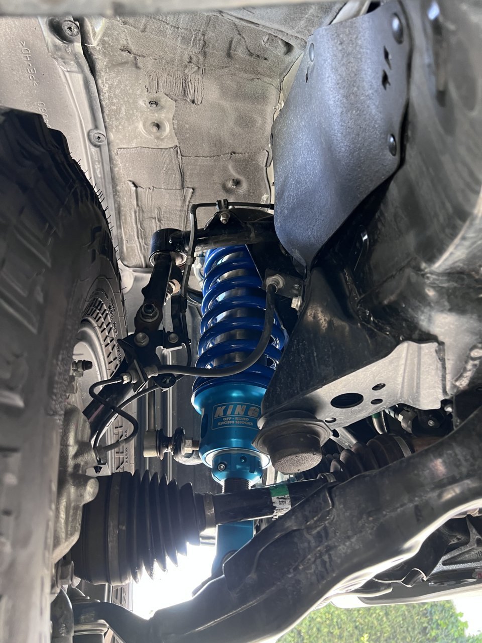

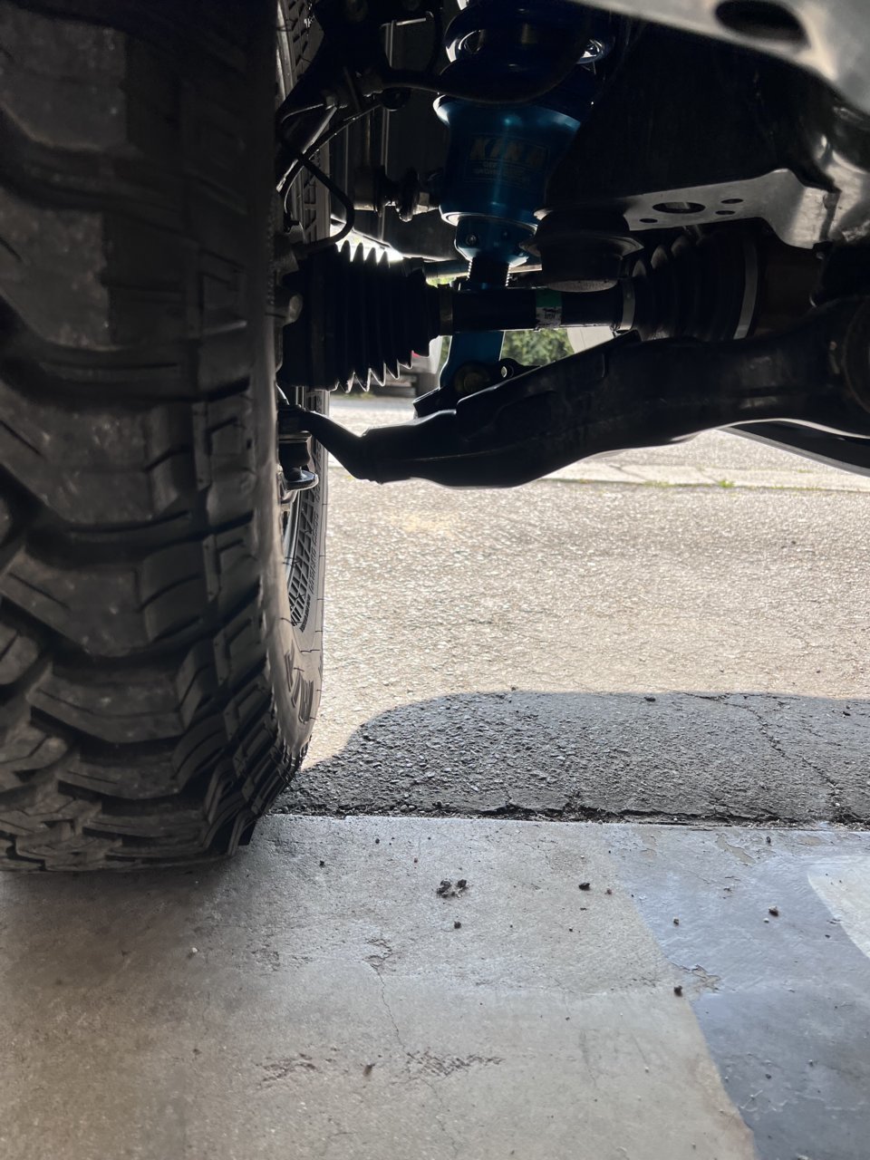

    KINGS ARE ON! Stock LCA’s work with these on the 2016-2023 Tacoma. Tubular UCA’s are the only style that work with the 3.0s because of the larger diameter coil spring on the 3.0s. 303 Shock Services offer the lower mounting bolt for the front shocks as the OEM ones cause the bearing on the 3.0s to wear prematurely and eventually fail. The rear has the icon AAL and nothing else besides the 3.0s. Happy trailing as I know I will. Hit me here if you have any questions.

    i just noticed these have their own bump stop on the shock. i feel like that really wasnt needed being a bypass and the truck itself already having bumps. would limit travel unnecessarily in my mind?

    i believe those king bump-stops would help preserve the shocks internal bump-stop in the long run when accidents occur on the trails. Or if someone is jumping it a lot. I definitely don’t need it for what I use my truck for. Do I want it? Who doesn’t?

    :101010: How much caster were you able to get with those elevate uca's?

    Looking to do 35's with it as well, so cab mount relocate is on the agenda. How do you think your uca's would handle a 35? Do they move it forward at all, or is it a more or less identical replacement for the OEM ones, just with a bit more clearance? Trying to limit the amount of cutting I do, so my choice of an uca is going to play a pretty big part in that.
