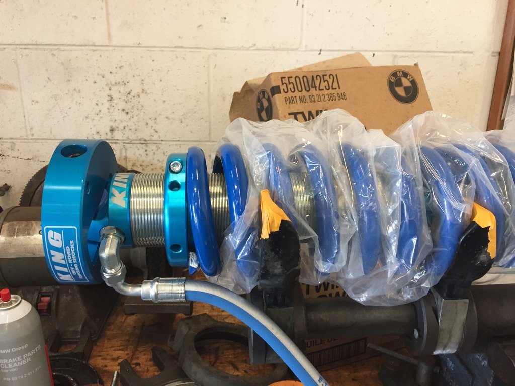

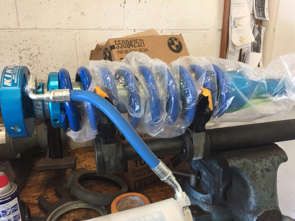

    Guess I will crank them up a bit over kill like 12-15 turns on the bench with spring compressor, install and let them settle for a week and then crank them down on the truck since everyone says cranking them up sucks on the truck. We going to try the other direction....pics to come with install soon.

    yea, i think I'm just going to over set them like 12-14 turns then after it settles, should be easier to unload them to level the truck rather than trying to crank them up higher after the fact.
    initial pre-load set, about 1" of threads exposed, approx 10-11 threads. Time to install and see what we achieve.

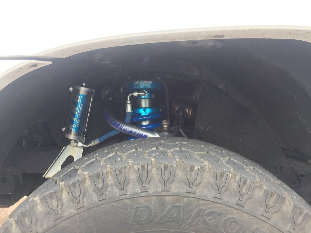

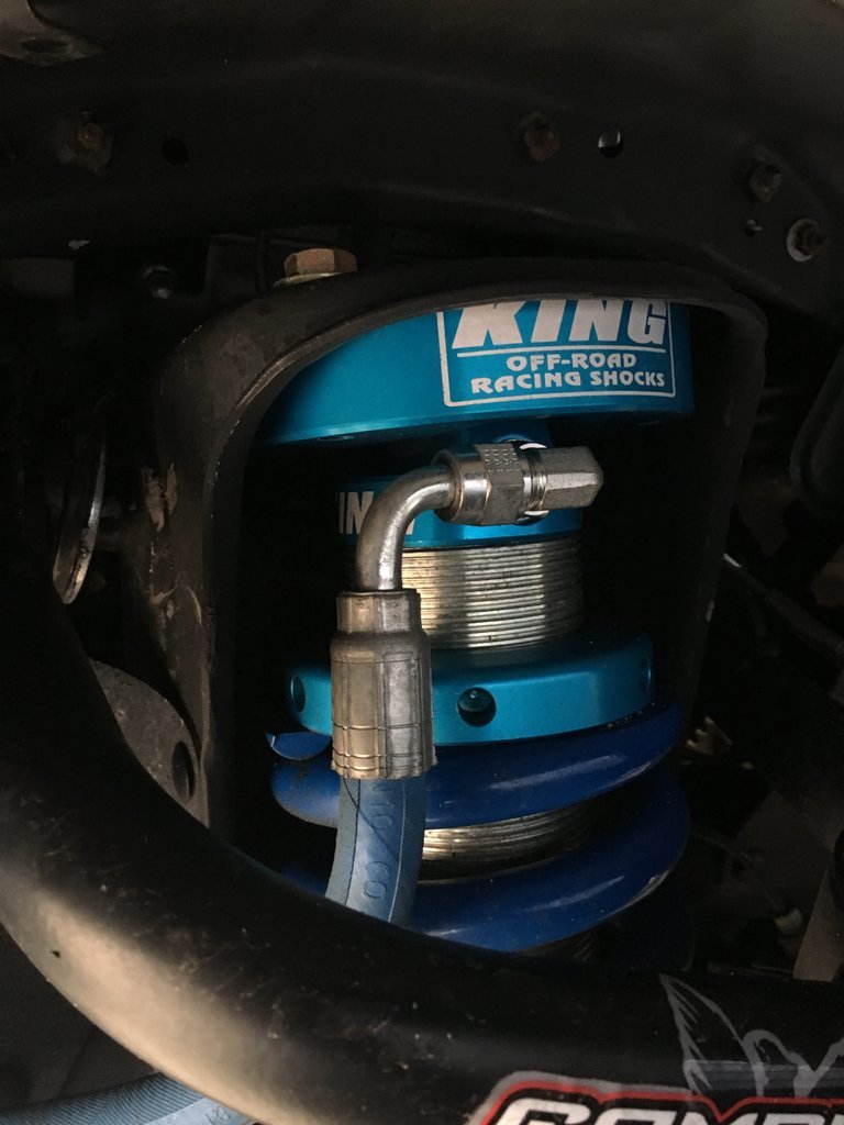

    Installed! Left the sway bar off and we will see how she handles after work.
    700# Coils

    They rode a little firm coming home today, might crank them down a little bit tmrw at work. Glad I don't need to crank them up

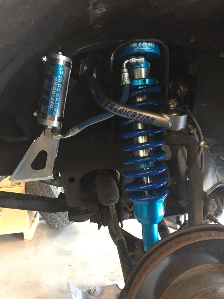

    Per say according to Kings: 4 exposed threads equal 1/2" of lift.
    My pic since everyone is posting there's: 650 lbs springs with adjusters
    BTW I have the Headstrong spacer for the taco lean. 2.5" of lift in the front :thumbsup:

    What kind of spring compressor is that?

    This

    I work at a BMW dealer (special tool), was almost able to turn collar by hand after squishing the spring down. Worked perfect
