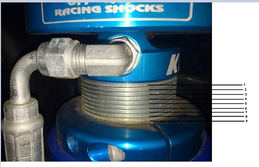

    This ( Cylinder sleeve spinning )happened to me! The shock cylinder started to spin with the collar. I just got off the phone with King since they are down the street from me, and told them the scenario. He told me if that cylinder moves at all, it means the seal was broken and the shock 100% needs to be taken apart and re assembled to avoid damage to the shock. They are charging a very fair pr for the work, but they said they will need to keep my shocks for at LEAST a week, maybe more since they are so busy. I really hope more people read this before attempting to adjust while on the truck, this is going to suck not having my truck for a week +. If I would have known this first I would have never attempted to adjust them while on the truck.
    Also.... the rep told me they don't recommend going any more than 5 full turns from stock adjustment. I am going to have them adjust the collar as far down as they are willing to because these 3rd gens barley get any lift from the Kings. I adjusted mine to show roughly 8-9 threads on each side and you can hardly tell my truck is lifted...:rant:. I am going to try to get them to adjust more than they recommend, He said the only downside to adjusting them more is that the ride will be shitty and "they wont perform like they are supposed to" . basically he was implying its pointless to spend the $$ on these shocks and then adjust them to the point where they ride like something that cost 1/4 of what kings do.
