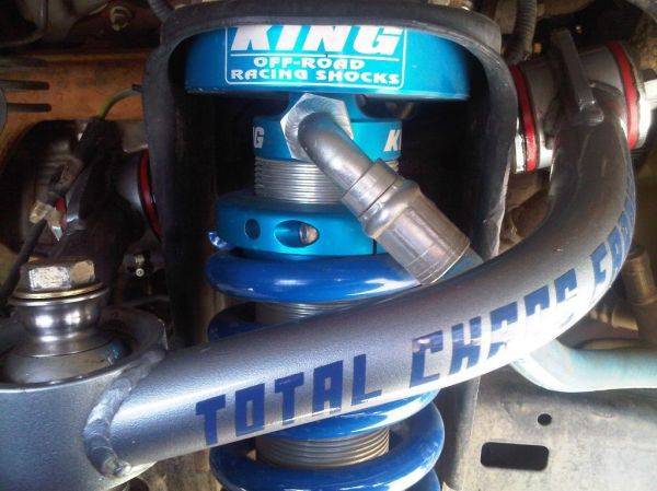

    Mine came with a punch to adjust. Was a total pain, even on the truck it was hard due to stuff getting in the way.
    This is how mine look right now. Set for 3" of lift. 3/4 inch of thread. 700# springs w/ Front plate bumper/winch, Full Skids.
