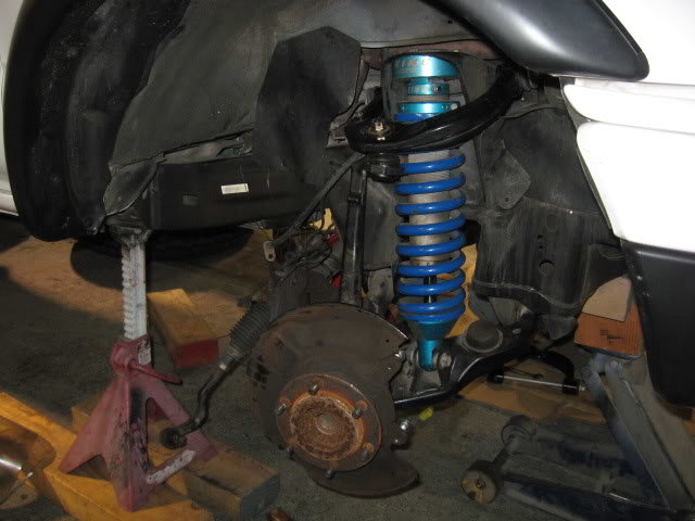

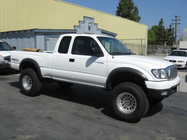

    Heres mine:
    LukeCC and impulsedtaco like this.
