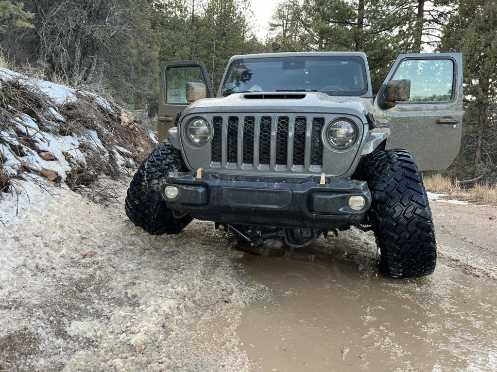

  4. Apr 22, 2025 at 3:09 PM
    02hilux
    02hilux What do you mean there’s no road, I’m here
    Sep 14, 2016
    #197244
    6,286
    Planet: EARTH
    like this? I’ll send it regardless

    -I'm not sure of anything at this point, only had a few minutes to look at it
    -Both wheels stand vertically. Not like the jeep pitured above Thank you for the visual reference!
