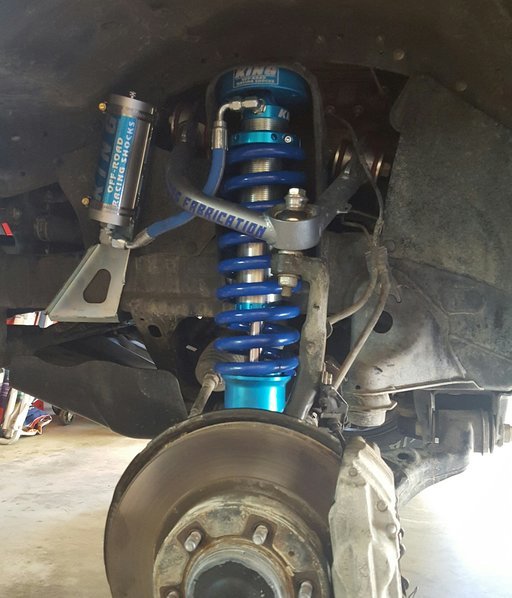

    This isn't a fantastic picture, but you can see the way mine are set. DSM preset them for me to match with the rear setup I have (Dakar Leafs) and I sit right over about 3" of lift.

    I didn't actually measure my threads showing, I can later if I remember. Mine came preset by DSM to what I needed, see pic above.

    Just found this which is helpful. Looks like we have almost the same setup I am about to install. I need to confirm if they preset my setup or not. I am guessing they were not from King. Do you have a picture of your setup @Mudfootshuffle?

    was this photo the height you have currently? Looked through the album and saw the other photo that showed it really cranked up (or down). The height setup looks good on the truck. I have the same setup, I am about to install after the new year.
