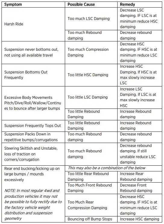

    Dobby's don't have a maintenance interval, yet are fully rebuildable. :thumbsup:
    Dobinsons MRR 3-Way Adjustable Remote Reservoir Shock Absorbers are equipped with 3 adjustable dials to adjust the amount of low speed compression damping, high speed compression damping and rebound damping... The shock absorbers are designed as an OEM replacement shock absorber and do not require any specific maintenance... These shock absorbers are 100% rebuildable...
    Here's the troubleshooting guide:
    DRAWN and rightushook like this.
