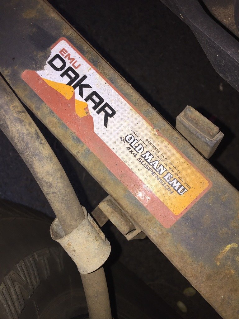

    Just installed a set of King rears and hit a speed hump table thing a lil faster than your suppose to and i think i felt a clunk when the rear unloaded. I have Dakar leaf packs which yielded about 3" of lift. Is there a solution like a spacer or something to move either my top or bottom mount points around?

    When I bought my King rears from @Downsouth Motorsports Micah had shocks made for Dakar springs. Extended is 25.25" Collapsed is around 15". Take the shocks off and measure. I'm pretty sure you can modify them to the extended length.

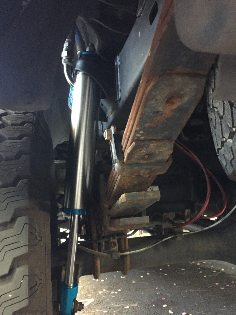

    I'm in talks with some vendors trying to figure it out. I only had to jack up the axle like 1/2" or so to get lower bolts in. Found the major clunk noise was my trailer hitch in the receiver is sloppy. removed that and haven't heard anything yet, i feel so stupid about that...dooooh

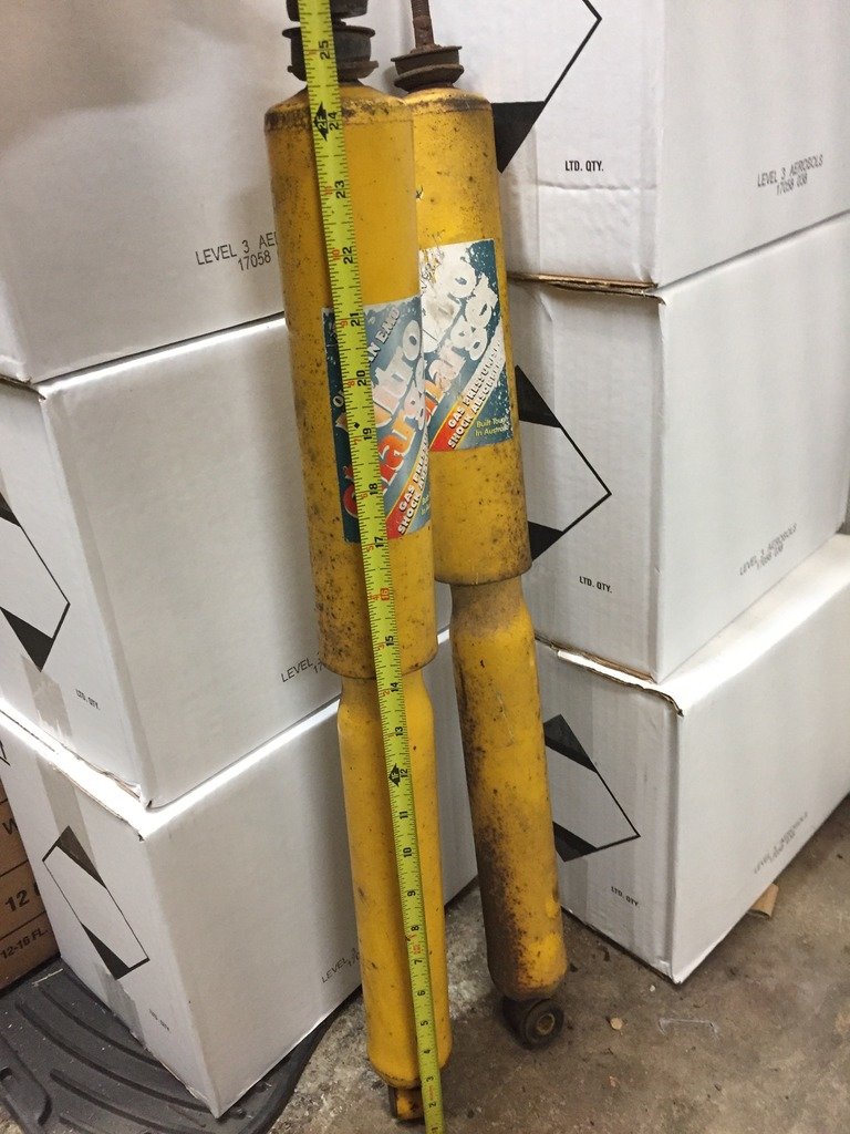

    they measure about 24.5-25" extended. I removed my loose sloppy fitting trailer hitch from the receiver and havent heard the clunk yet. Pretty sure that was the noise i heard flying over that speed hump.

    Old shocks measured from the ground up, not eyelet.

    the standard king OEM shock is 15.83/24.29. when you bought them from whomever you got them from, did they do any modifications to make fit on the Dakar kit? if not they are too short and will definitely make a clack when over extending.
