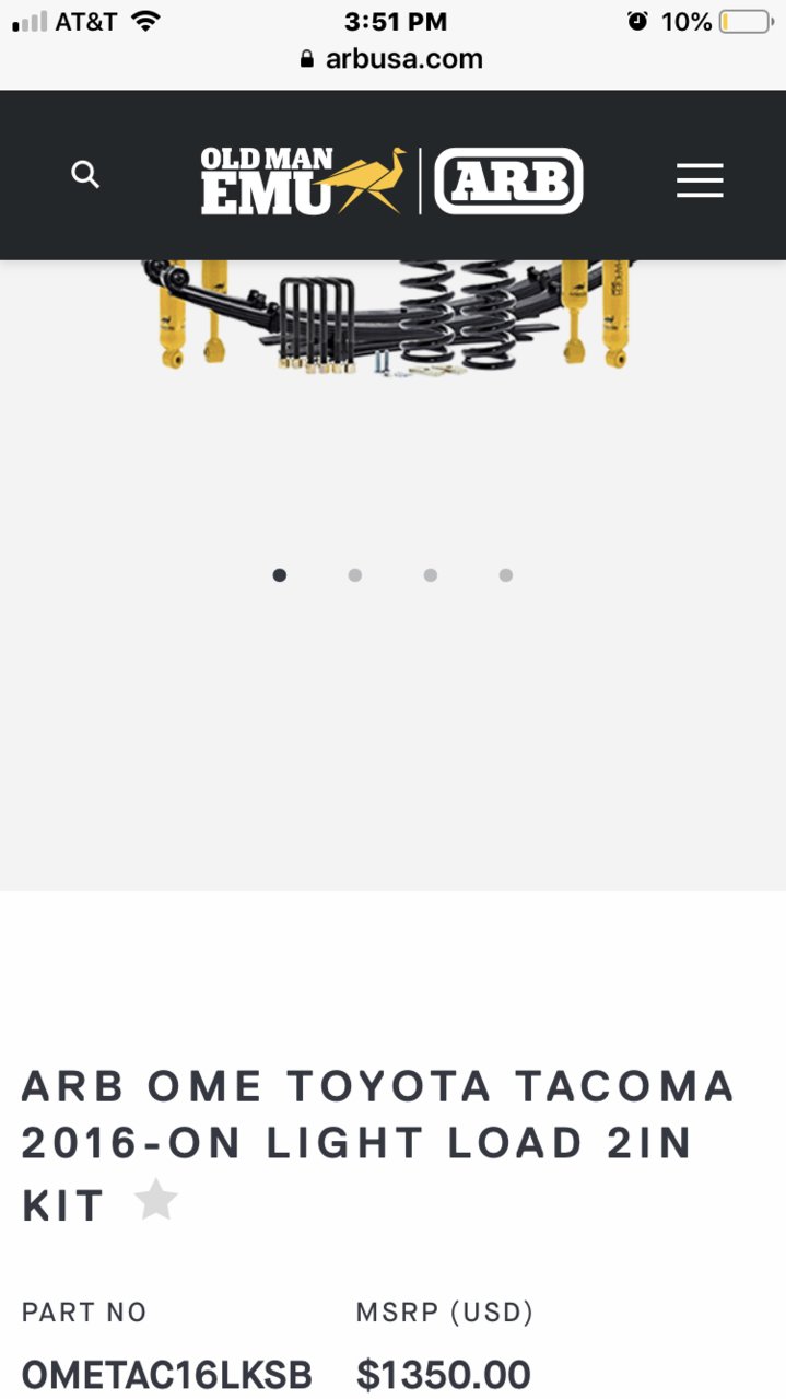

    My understanding is that the arb kit lifts up to 2 inches?

    yup, 2 - 3 inches depending on weight, if you have an add a leaf, etc. But that's why the King shocks won't work with those leaf springs...the leaf springs lift 2" and the King shocks are only long enough to work with stock height. If you put the King shocks on with those leaf springs they will get over extended and ruined in short order
    edit - and yeah those are for 3rd gens not 1st gens. But the idea is the same, you want to pair the right length rear shocks with your rear lift. That kit you quoted comes with rear shocks that OME designed to work with those leaf springs, but if you wanted to swap out the shocks for something else you'd need to make sure you got the right ones.

    You are quoting a different product for a different generation vehicle.
    Please do not post advice that may confuse others.
    The King rear shocks he mentioned are made as a factory upgrade/replacement at stock height.
    With the OP's springs, he has a 2" lift (approximately) which is why we are advising against the use of said shocks.
