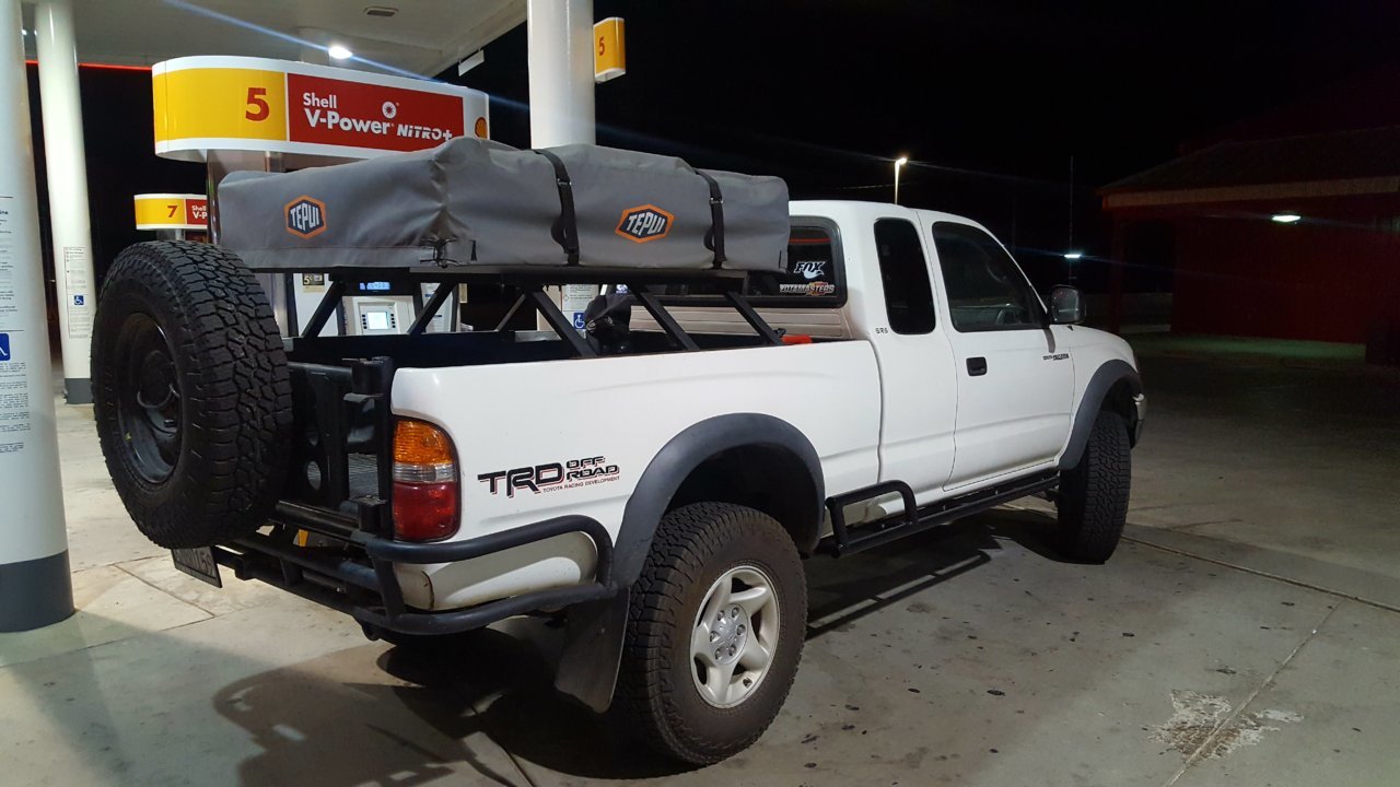

    I considered Deavers but without knowing how much I was going to carry and how often, I went with Dakars.
    Tons of people love their Deaver leaf pack, but I was advised to stay away from them if I was going to carry a full combat load -
    As you can see, I still have a tiny bit of rake left.

    Yeah from what I've heard Deavers are stock load rated springs (maybe even lighter)...good for a nice plush ride but not for carrying much weight

    Are those foam or rubber bump stops? I should probably get those too.
    Now going down a rabbit hole. I asked several different places/people about needing limiting straps up front when I install the extended king 2.5's, to protect the cvs, brand new tie rods I just put on, etc. They say the coilovers are built with a stop or something to protect everything at full droop (I have a diff drop too).
    I didn't realize those King rear shocks are meant for stock ride height, but I like the idea of something like that, what would be another King rear shock option? I'm definitely not doing the shock relocation - requires welding on the frame, just one of those things where I draw a line in the sand.
    With the deavers, I am still curious about load/weight limit in the bed. I still want to be able to carry stuff, but not gonna have a bed full of sand or something. Also pull a trailer when I move, most likely 6x12 with my street bike and dirtbike in the back.

    Only quoting to answer the first question you asked; they're Superbumps bump stops from Wheeler's.
