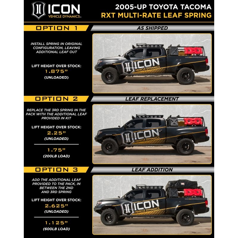

    I added a missing image to the product that explains the lift heights (see below)
    The Icon springs appear to be softer than the Dakar packs, which may or may not be a good thing.
    If you're loaded with 600lb or more all the time and want 2-3" of lift the Dakar pack is the right choice.
    If you're not loaded with as much weight or don't want that much lift the Icon pack might be a better choice.
    When setting up suspension to ride well we want softer springs and stiffer shocks.
    All of the bolt in replacement shocks are too soft which is why everyone is looking for stiffer springs (front and rear).
    Proper springs and shock valving would result in a much smoother, less bouncy, and more controllable ride.
