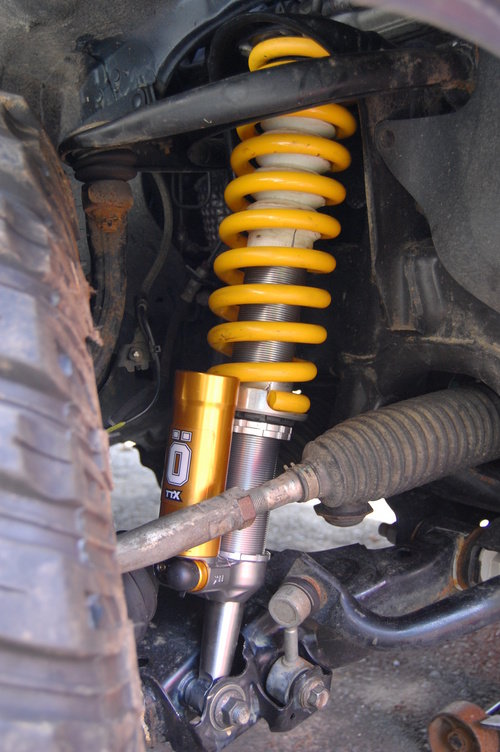

    You should be fine. While it will run through the travel a teensy bit more easily with less preload on the springs, the ride quality will be better. Also, with no or little lift, your roll center will be lower/closer to as designed... it should handle very well.
    Since you mention Ohlins... Here's an old teaser for you. These are TTX44 Shocks I built for a Tundra about 10 years back.
