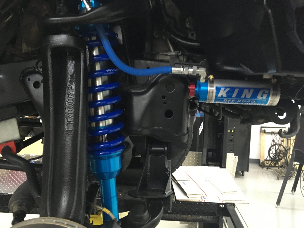

    Here is the passenger side completed (yes...I am one of those Drop Bracket guys. It works great for me)
    Taco critter likes this.
  7. May 13, 2020 at 5:56 PM
    gsrogers
    gsrogers [OP] 2003 TRD 4X4
    Jun 19, 2017
    #221875
    146
    Garry
    Friendswood Texas
    2003 Tacoma DC TRD 4X4
    Fabtech 6" with Alcan 6" rear springs 33" Nitto Terra Grapplers
    One more
