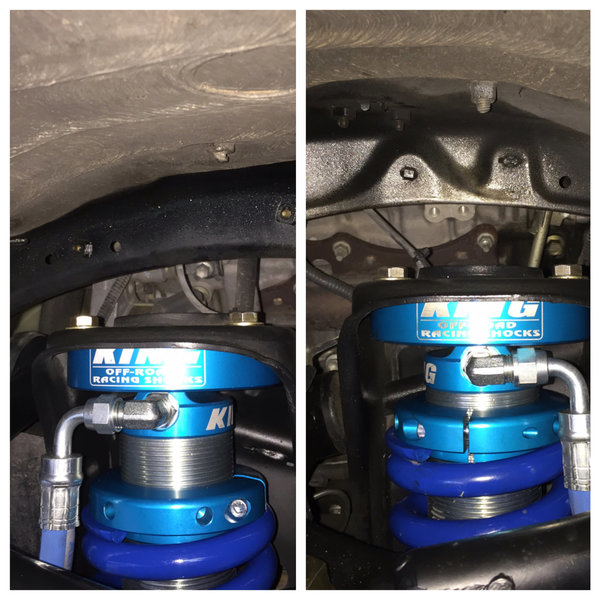

    Finally installed my coilovers this past weekend. At first I didn't adjust the coilovers at all. Just installed it right out the box. I was running out of time so didn't adjust it til today. Out of the box, it gave me 1-1.5" of lift. So today I started cranking the driver side down 7 turns. It's about where I want it, 2.5". Drove around the block to let it settle a bit and measured again. For some reason the passenger is now even with the driver side. That's without me adjusting the collar at all. I can see it being 2-3 turns of the collar difference but not 7. Is there something wrong with this?
    Driver on the left. Passenger on the right. Passenger is still 1/4" higher. I checked the springs and they're identical.

    Yea that's how mine are. Driver side sits bit lower with the coil overs cranked higher than passenger.

    With my kings, the truck sits even with the drivers side 2 full turns more preload.

    My truck sagged on the passenger side despite a lot of pre-load, and none on the drivers side.
    Swapped in a new set of coils, problem solved.
