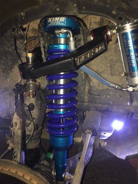

    Funny, I ended up getting 600lbs springs I think when I got my GB. I did not tell them what to give me, that's just what I ended up getting. How can I confirm they are 600lbs. Should be written on the springs right? It says E300-14-600.

    Thise are 600lb. The 600 at the end of that number is spring rate

    How do they feel,
    do you have any added weight up front? How do you like them? I'm torn between 650 and 700. It's still a DD but gets a workout often off road. 3rd world problems are the worst.

    That means the springs have a 3" inside diameter, 14" in length, and 600lb rate.

    I will be honest and say that the ride seems to be harsher but I'm fine with that. It is a truck after all. :) I do not have any added weight up front. 650 would be your best bet IMO.
