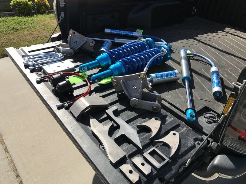

    Received mine yesterday! :bananadance:
    dumontrider and Lord Helmet like this.

    12" relocation? Me too!
    What shackles are those?

    Yup! 12" relocation!
    Flip is @ARCHIVE Garage

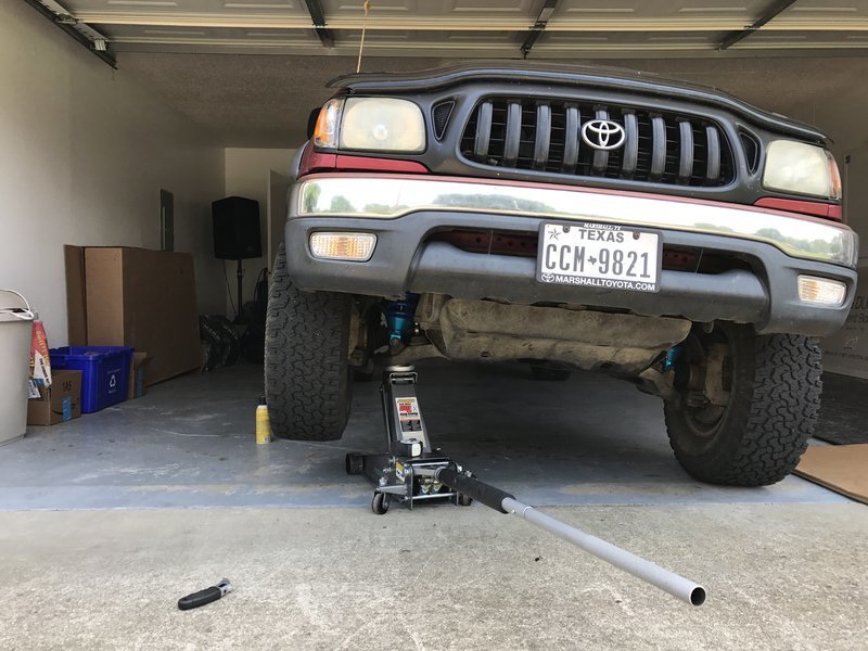

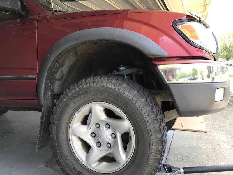

    Shock isn't bottomed out, and definitely not on the bumpstops. Here's pics of the shock, bump, and upper ball joint jacked up and the preload on the coil. Other side is pretty much exactly the same. I measured from the center of the hub to the fender and there is no change from ride height. So I have no up travel at all. There's got to be something wrong.
    I did but I'm pretty sure that only matters for droop travel where the upper ball joint limits travel. The physical size of the coilover is the same. There's just a spacer taken out that lets it droop out another inch or 2. Even if that was the case, I should at least get an inch or 2 of up travel. I have 0.
    I tried loosening the uca bolt and retightening it with the truck on the ground and did the same with the lower shock bolt. No change. What should the pressure be in the shocks? Any other ideas? Thanks for the help and suggestions.
