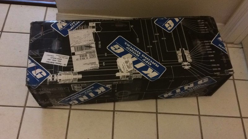

    Just arrived today. Guessing both fronts are in the box?

    Yes... Or you could open it and find out.

    Ya they're packed in there like sardines, very intricately molded foam.

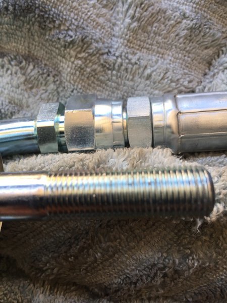

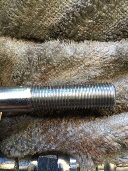

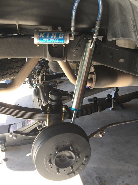

    Install my rears today, king QA dept missed this, so I had to run a 1/2"x 20 die because the nut could not thread on.

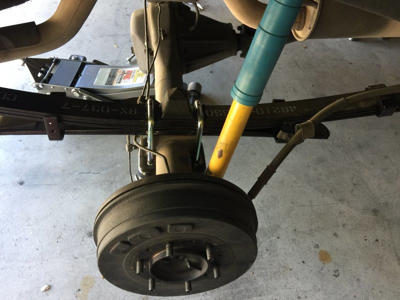

    Before
    (Thanks OP) Now waiting on the fronts to come in...Hopefully soon.

    Is this for the top of the rear shock mount?

    Yep the top. At first I thought they sent me the wrong nut, so I broke out my thread pitch gage and found out the threads were not finished. The guy assembling my part prolly thought he was done and sent it to shipping. I reported this issue to king and asked them to send me a trucker hat lol
