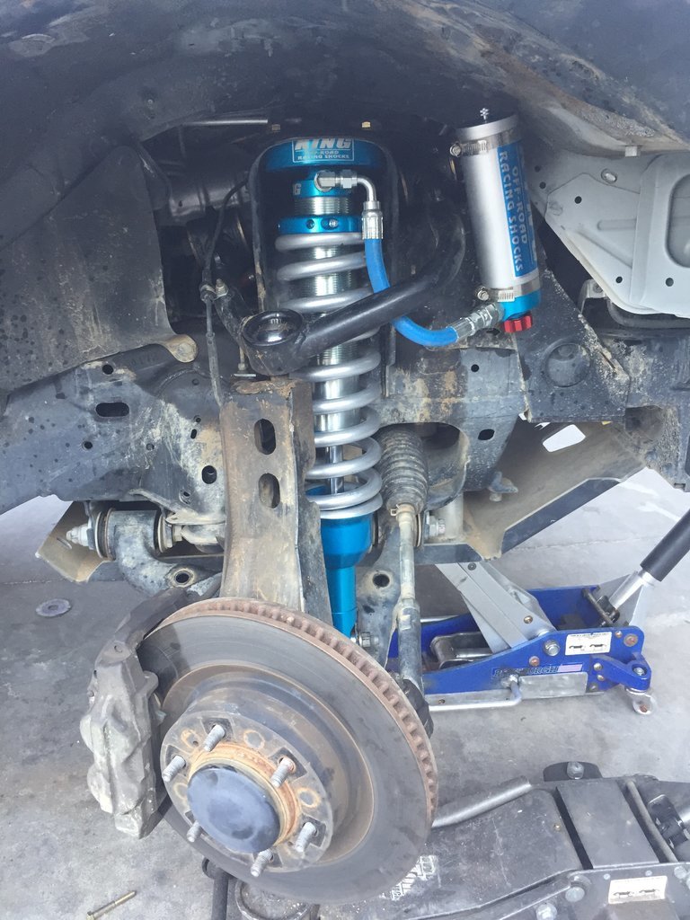

    Hello All
    I had a question about everyone's install on these - the lower mount for the front coilovers to the LCA. Did any of you guys notice that the gap between the ears of the lower control arm mount was significantly larger than that of the mount for the kings? I put washers on both sides of them and thought it was odd that Kings didn't supply anything. I was just lucky to have washers that fit the hole and were the correct thickness.
    I can take some photos at lunch.
    Also another thing - has anyone encountered creaking noises on down travel (decompressing the spring) after off roading and washing the truck? I took a can of PB Blaster and sprayed different areas of the coilover and found that the creak is coming from the spring rotating as you take load off the vehicle.

    Forgot to post that I got to test mine out
    Tested them out and they are great!
