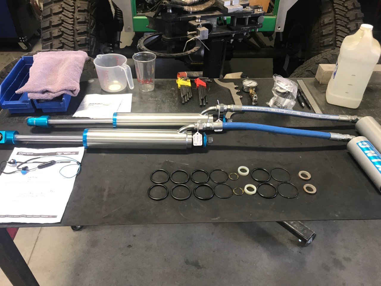

    To clarify. Ext shocks don’t give an extra inch of travel. They remove an internal spacer which provides, at MOST, 5/8” of an inch. To leverage this you also need aftermarket UCA as stock UCA with just hit the coil.
    Kings out of the box are usually set at 5 threads (prelod) which is about 1” of lift. You’ll need to adjust the coilovers to the desired lift height but 2.5” is about all you want. The amount of preload varies and depends on the truck weight and spring rate you chose.
    Also most trucks aren’t reporting 1” difference from driver to passenger, usually about 1/4” or so.
    Be careful whose advice you buy on here.

    You don’t gain 1” wheel travel. Your up travel is the same.

    No shit, that number is not 1” it’s at most 5/8

    Ya hence why it's 5/8. A casual measurement to most would be 1/2" or less. Thats why extended shocks are kind of a joke.
