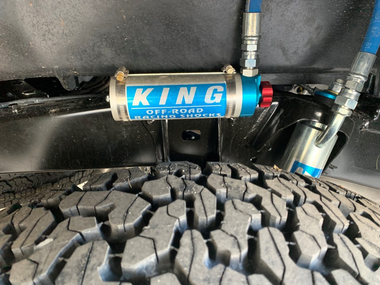

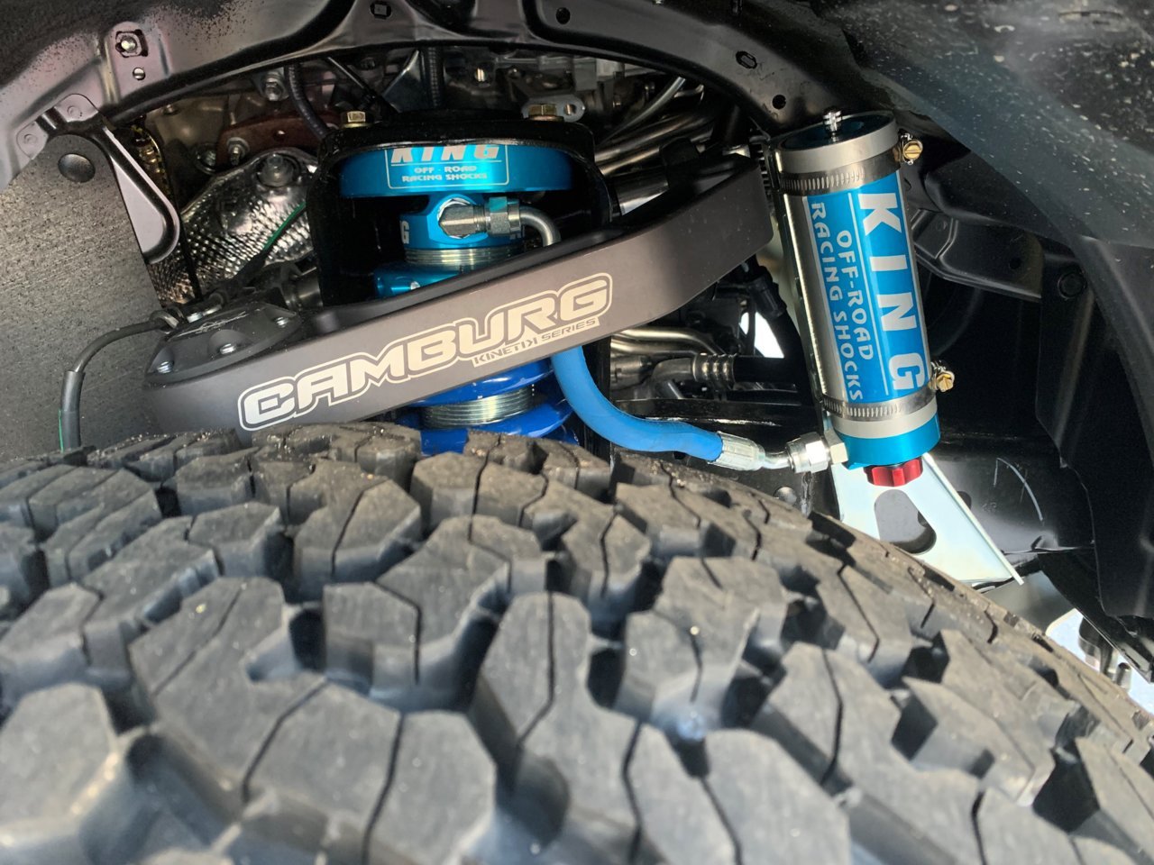

    I replaced my stock 2020 TRD Pro Fox suspension with a Kings 3" 2.5 suspension.New Truck 6.jpg New Truck 7.jpg
