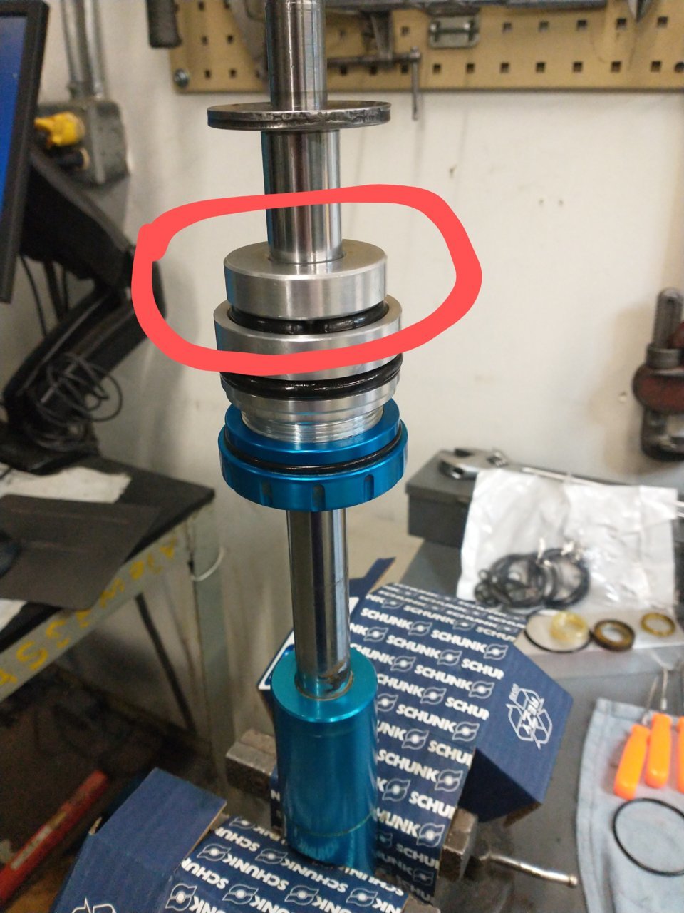

    Rebuilding some used shocks. I'm working on a pair of 25001-119A-EXT. Has anyone tried running these without the 0.5" spacer? Or maybe a thinner one? See attached.
    Any reason not to? With aftermarket UCAs, what binds next? Lower ball joint? UCA on coil? (I guess that depends on the arms) cv joint?
    I have already confirmed with King that they are, in fact, extended as setup now with the 0.5" spacer. The Non-extended configuration has the 0.5" spacer I have, PLUS ANOTHER 0.25" spacer.
    From king:
    Standard configuration : 0.5" spacer + 0.25" spacer
    Extended configuration : 0.5" spacer
    Anyone taken the 0.5" spacer out all together?
    If so - where did it bind? Tie rod ends? Cv joints?

    According to King on the phone:
    Standard travel = 0.5" spacer + 0.25" spacer
    Extended travel = 0.5" spacer [As shown in my Pic]
    The guy on the phone was referring to some documentation while on the phone, so I take it as fact.
    My question is if anyone has experience removing the 0.5" spacer all together and running them with no spacers at all?
    ... Or maybe turning it down to 0.25" or similar...
    When I asked the king tech about removing it, they gave me the expected "be careful" disclaimer. I suspect the cv might bind or be close to binding...

    I did wonder if that big steel washer would deflect without the thickness of the aluminum spacer. But... At that point, the shock is topped out, so spring force is min (as low as it is preloaded anyways) it's not the weight of the vehicle on the washer.
    I can tell you the rears do not have a spacer - the seal head tops out directly on the steel washer in my Pic.
    So the logic that the spacer is providing some sort of lateral shaft support is simply not valid. The spacer is significantly smaller diameter than the seal head. All it is doing is limiting shaft travel.
