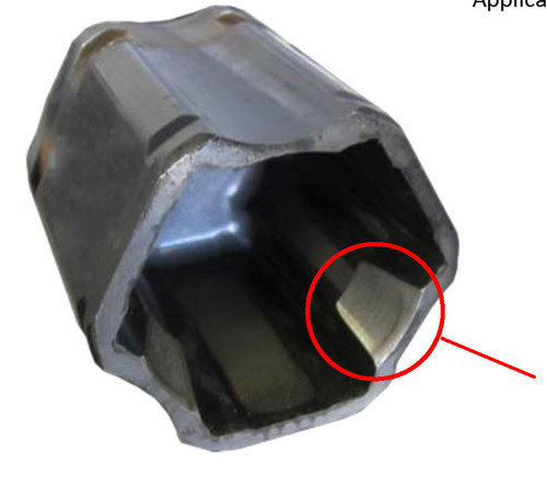

    I guess I dont really see how the aluminum spacer circled in OPs pic could help with anything structural? But I am curious cause I dont really know shit about shocks
    Seems like putting it back together and cycling it real quick would be the way to go. With pictures of course

    Providing a spacer like that COULD reduce the max amount of deflection of the shaft by increasing the distance between the 2 support points - the DU bushing in the seal head and the wear ring on the piston head. The closer the two support points are, the more the manufacturing tolerances would allow the end of the shaft to deflect.
    Im 100% gonna try it myself. Wasn't expecting the dog pile, but I guess I shoulda known. I just thought someone might have tried it by now.
