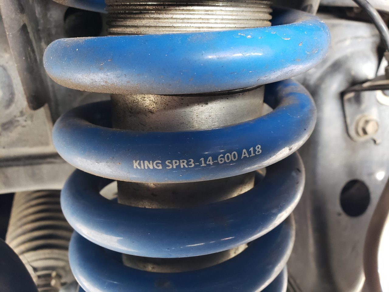

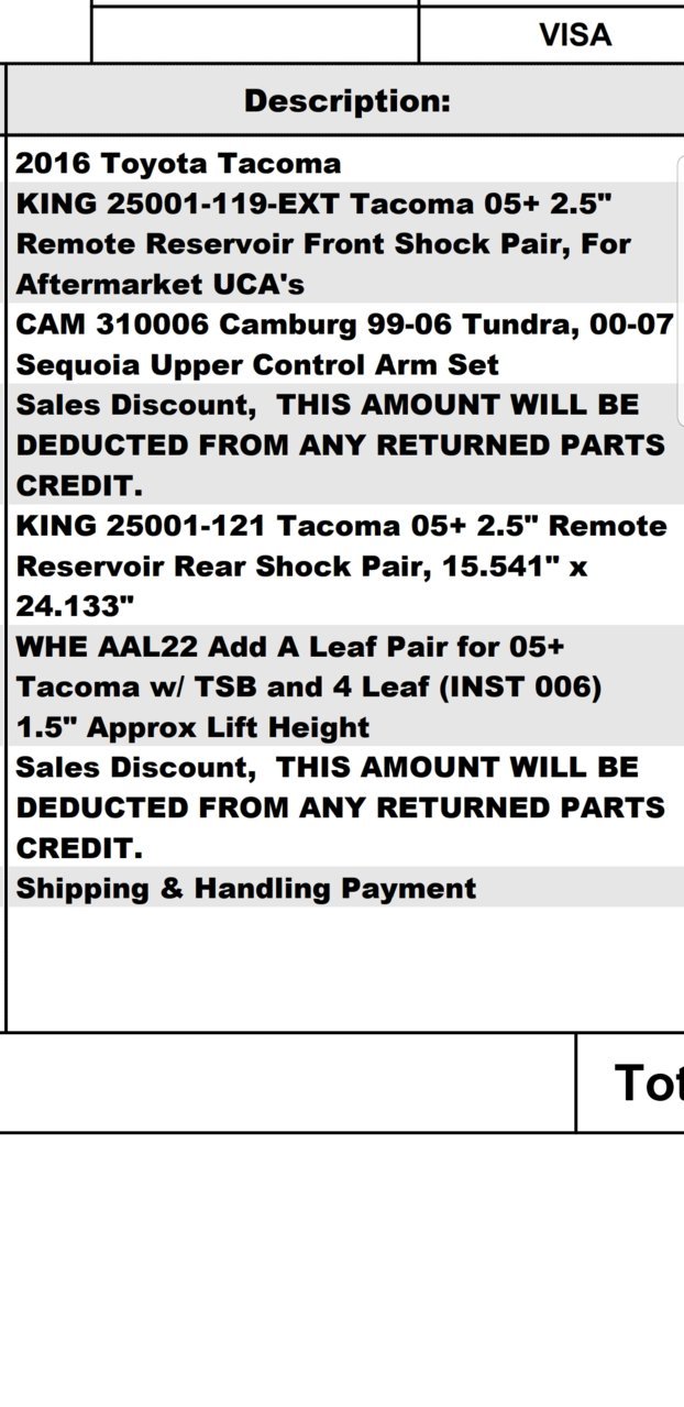

    What is your spring rate up front? What leaf pack did you go with? Do you have adjusters on the shocks?

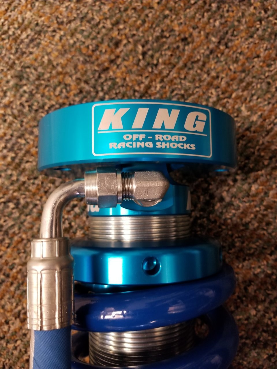

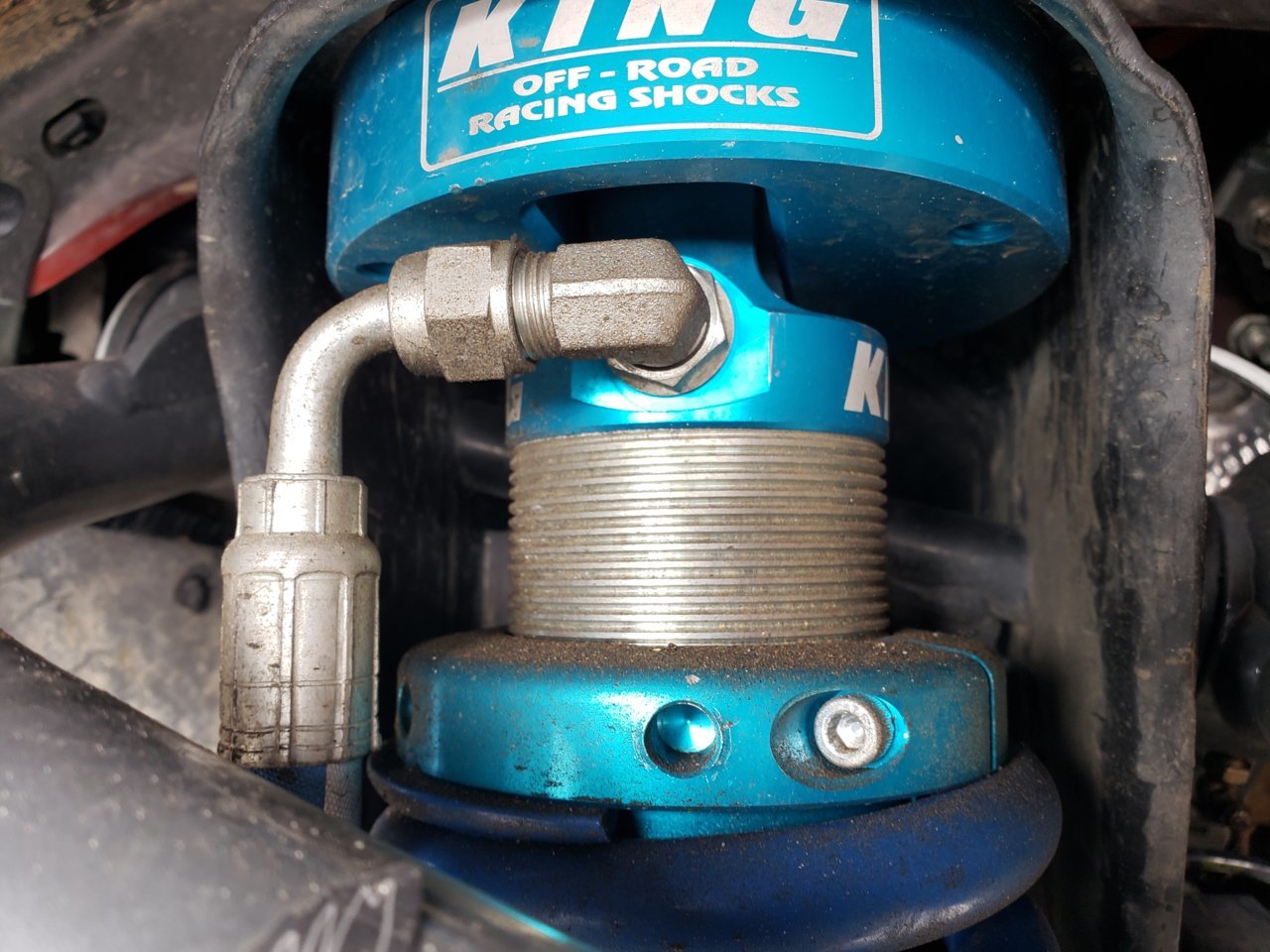

    Take a pic of your preload on your fronts. Also what’s your spring rate? You might need to take some of the preload out

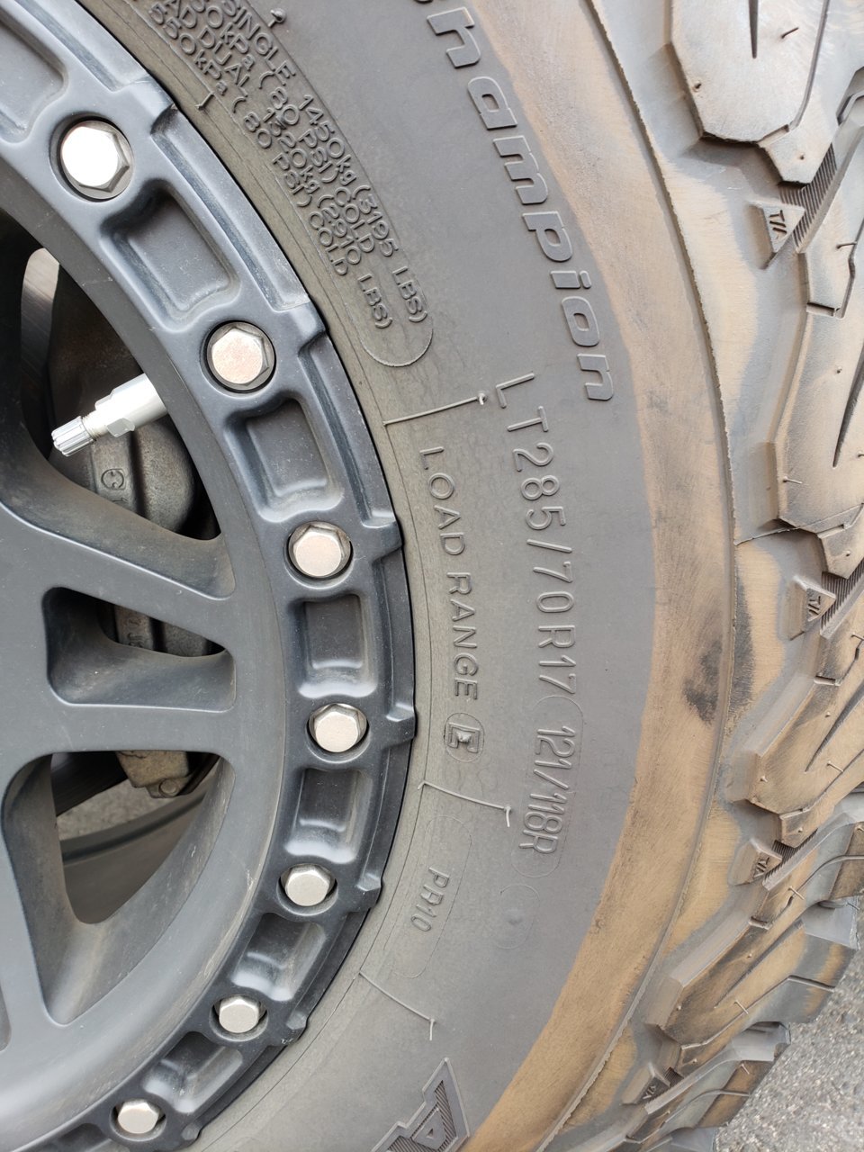

    Are you tires ELoad....

    @Ravnikar610 they are not adjustable King shocks unfortunately and I attached a picture of the leaf pack and my whole entire set up.

    @El Duderino the lighting is so bad right now because it's night time. I'm going to take a picture in the morning when I wake up. I'm curious to see how you are able to calculate the spring rate. I just wanted a higher lift. I'm thinking maybe I cranked the shocks down too much.

    What PSI are yoi running in your tires? I’m assuming they’re LT (load E) and if there’s too much air in them, your truck will ride like a dump truck.

    The coilovers spring rate is printed in white on the coil.

    ^ my guess is preload and tire rating like most said. When I went from C load to E load, I could tell a huge difference in lost of ride quality. I can feel the road quite a bit more. Tried lowering the PSI and that helped a little but missed having C load on my daily driver. I didn’t want to dump more money into tires again so I’ve learned to deal with it until I need to change them out. Some may say E load is overkill for our trucks but the benefit of it is being able to air it down more for sidewall traction while off-roading. Just depends on how you use it.

    A single add a leaf, is going to be a lot stiffer, than a 3 leaf progressive.

    I have the same shocks and the standard spring rate is 600 which as said above is printed on the spring. The keeper ring on my front coil overs is turn down about 3 threads. As said above, if tires are E load rated they will be hard as a rock. I had E rated tires and went to a C rated tire and it made all the difference. If your tire are new it is possible seller may swap them out for you. Discount Tire did it for me but it took some arguing. Not sure what you have going on with rear suspension.

    id bet its the tires i went from oem to e load 265/75/16 ko2's and i lost alot of ride quality

    Way to much pre load on those. These are mine with 650's set at 2.5 inches of lift.

    I had this same problem and ended up going through the mistake of thinking it was my suspension, probably changing it 4 times like an idiot.
    I went to C-rated tires and got rid of all forms of preload, solved the issue. It was 90% the fault of 10-ply tires on a stock-ish truck with no armor.

    Those are standard 600 springs. When I didn’t have any weight in the front with 8-9 threads showing, it was pretty close to 2.5” of lift which Kings recommends not going any higher than 2.5”. Looks like you have 12-13 threads showing.

    @runmc they are E load.... daaaaamn. Thank you for the info . once these tires were down which is probably going to be a while because they pretty new but used. I will see if I can step down to a c load hopefully it'll soften my ride.
