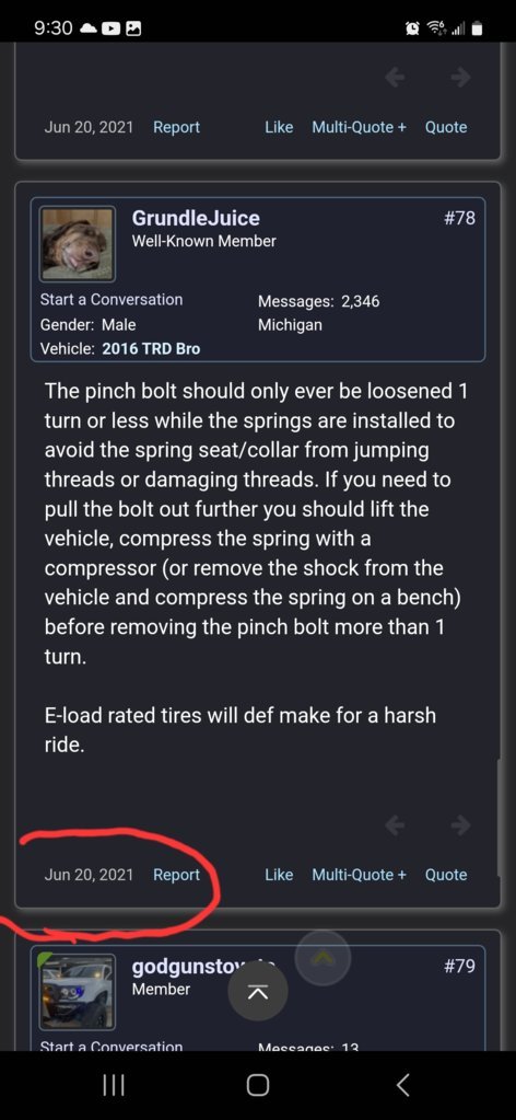

    I feel like this conversation has been dead for awhile.
