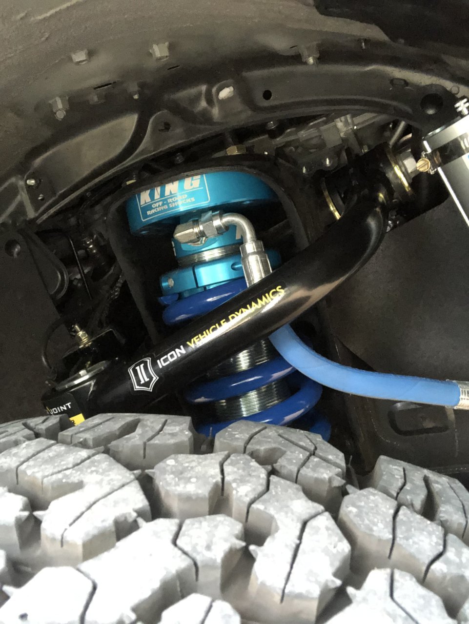

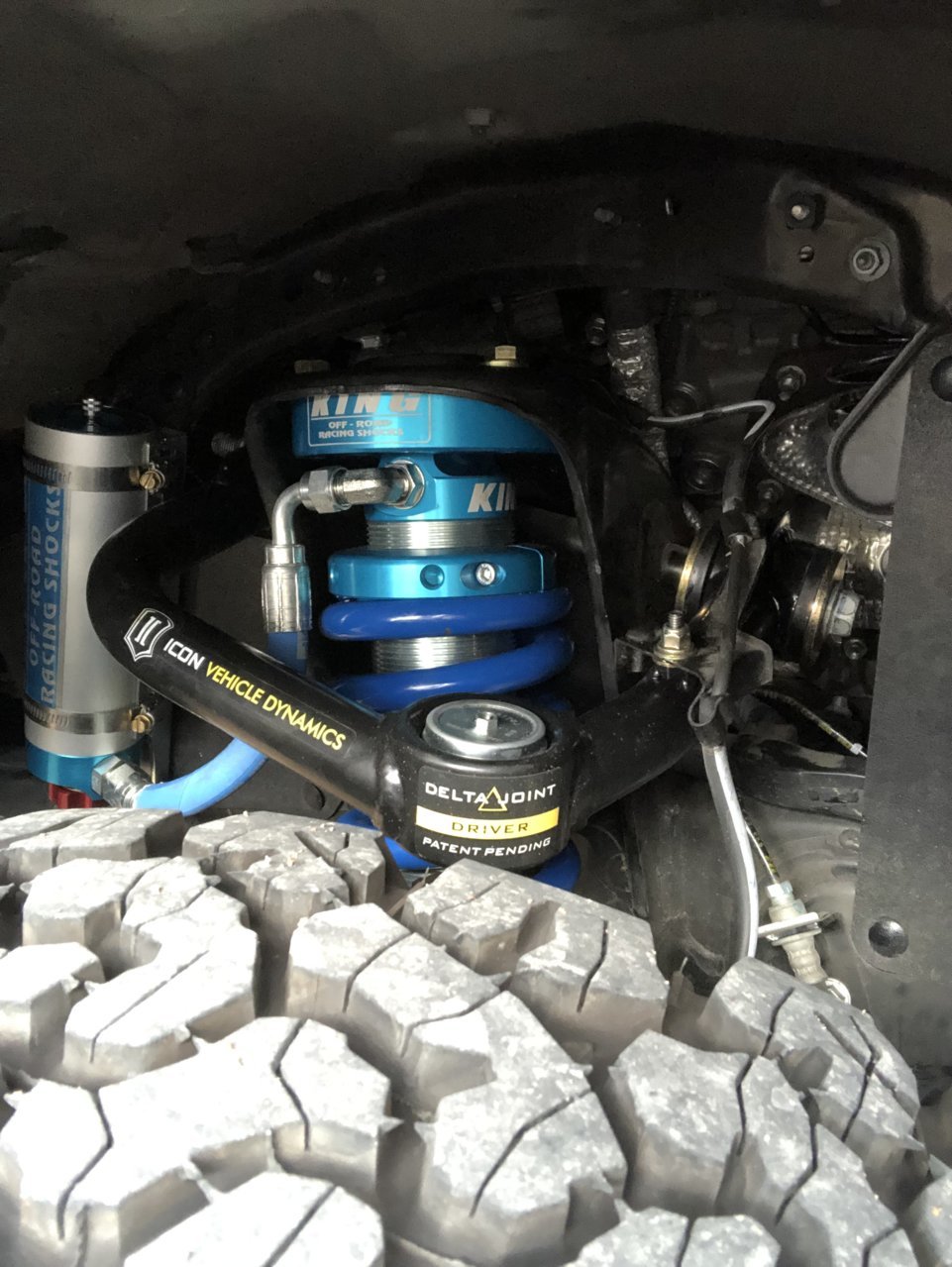

    1st image: driver side
    2nd: passenger side

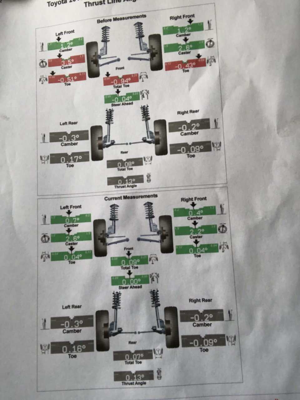

    3rd:alignment specs

    Can’t find the rubbing anywhere seems like it’s on the coil. I Feel it when making turns. Tire size 285/70/17

    @Brofessor have not yet taken measurements. No trim or cmc yet. Coil on driver side looks Slightly scuffed up.

    before you start hacking away, you will need to determine where you are getting your rubbing.
    It is very likely that you are rubbing your tire in the front fender-well and in the back, as well as the cab mount.

    I had those same UCA's and my caster liked to be in the 3 to 4 realm. I think you hit the nail on the head, the alignment shop was fighting it.
