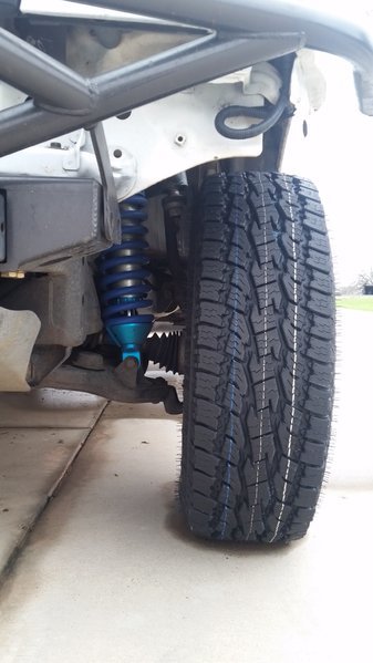

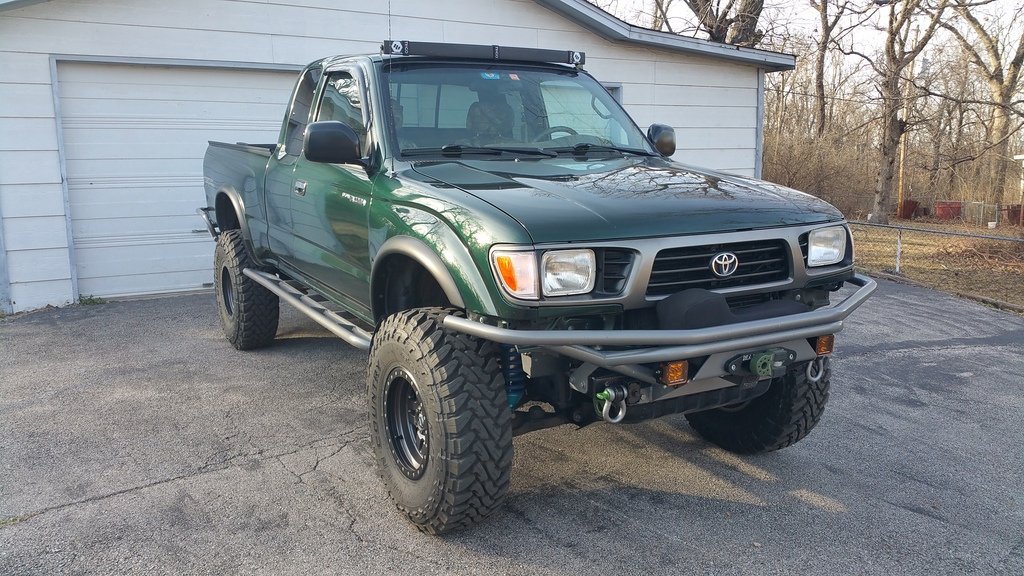

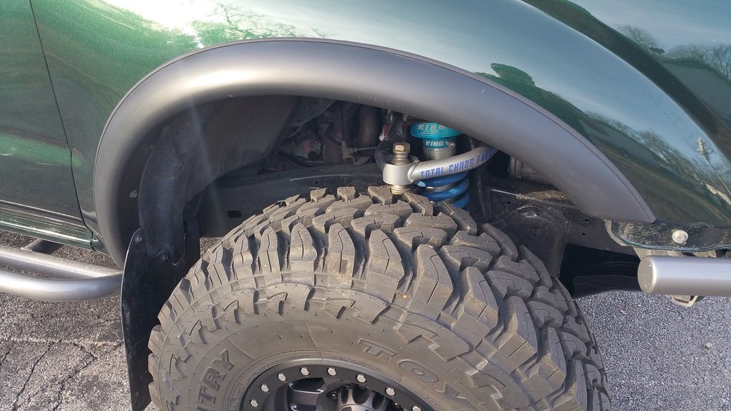

    King Extended travels up front on Total Chaos arms from @Downsouth Motorsports. OME Dakars on Nitrochargers. 265/75r16 Toyos. They are set around 2" of lift in the front and I've been pounding the hell out of them to get them to settle and adjust the Taco Lean out. Worth every penny. About to pull the trigger on Solo Motorsports WIY outboard shock hoops and King 2.5 for the rears. tmp_15499-IMG_12541-1026992962.jpg tmp_15499-20170118_163028-451609468.jpg tmp_15499-20170123_1614081026069617.jpg

    youl probably want 1.5" or even bigger wheel spacers to clear 2.5" shock bodies outboard of the frame.

    That looks like a close fit but very nice man. If you cranked the kings up to 2.5 do you think 275/75/16 tires would fit?

    Yes 285s will fit, I have a set from another truck that I test fit when I puth the kit on. It is my daily though and I needed a smaller tire for the 2.7l. And as for @devinzz1 question, there is a write up from @Willbeck on this here:
    https://www.tacomaworld.com/threads/rear-shock-relocation-thread.261770/page-12
    I cannot remember if he his running stock wheels though. I will probably move towards getting Konig Countersteers and spacers if the fitment in the rear is too tight.

    He had 3.5"bs with smaller tires and still rubbed when articuating. Stock wheels are 4.5"bs.
