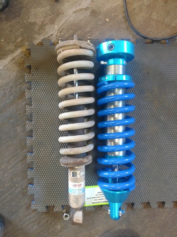

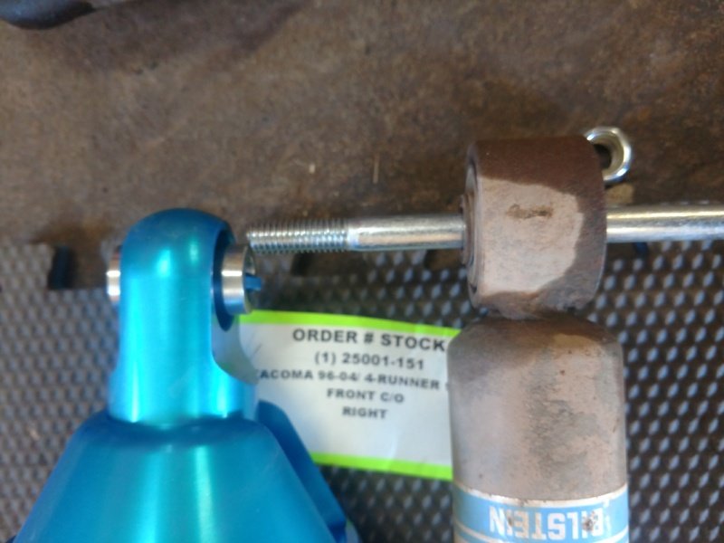

    Getting around to installing these finally! Question though... In the pics below you can see that the king's are currently set to about 1/2" shorter then my 5100's... Now with the Eibach coils being 620lbs and the new king's 700, is it safe to assume they will sit around the same height, or should I go ahead and adjust the king's while they're still off the truck?

    Adjusting the springs on the Kings won't change the length of them, only the preload on the spring.
    I'd put them on the truck before you make any adjustments, and then I'd adjust them to have as little pre-load as necessary. You'll get a better ride, and be easiest on your CVs that way.

    Now that you said that, I'm looking at them like ..."duh, shoulda known that" :rofl:
