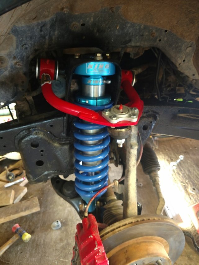

    Buy shock seals and uniballs at http://shockseals.com/ I’ll be making a rebuild how to eventually. The hardest part on those oem length coil overs is getting the springs off since they don’t fit most spring compressors.

    Got'm in... Now I just need to install my new steering rack bushings and torque everything to spec!

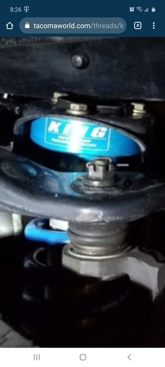

    Is that reinforcement on your knuckle or did you weld together a new knuckle and UCA?
