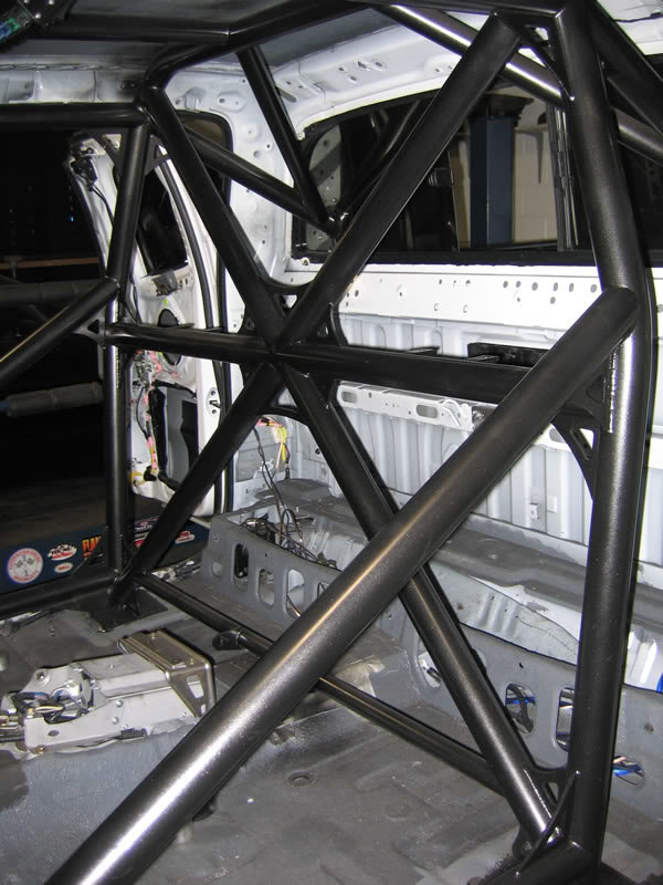

    I've got rust everywhere but there's no way I'm getting a new frame. I have too much tied to the frame so I'll just cut out and replace the rot as needed.
    Off topic but since I'm posting pics anyway...I'm presently resurrecting my pile with some revisions.

    I love the job he did on that bed setup. :cool:

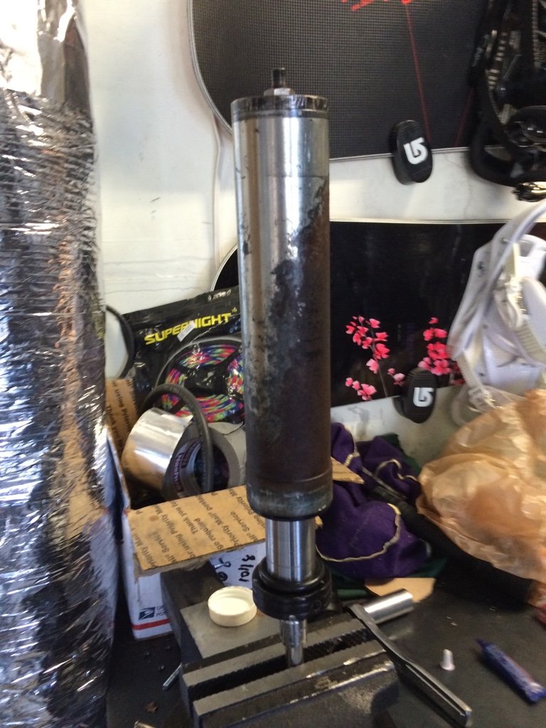

    Gotta love that fox finish...

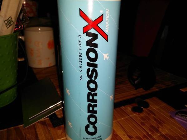

    I sprayed it on a rag and wiped down the coilover. I spray some right where the adjustment collar is so it doesn't get frozen on the shock body threads and then wipe off the excess.

    Nice that is what I figured. They look brand new!

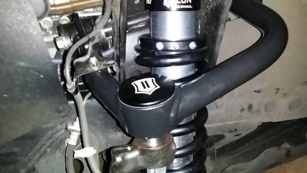

    Well I just picked up some T-9 and coated my icons and lead pack with it for a little preventative maintenance for rust. Should dry to a "thin waxy film" so hopefully it works alright. Anyway here are a few pics.
    f16f0cd95a10e8ea664faa0cebf595e4_260441b56e9d20e27d20f22fee29bea63e4764da.jpg8151056522dd4ba8c074c0b42d006326_fbdf10f51af6de46f15494c1ddc15a8cc74a071d.jpg0fd0627d928abfd7a06250f764f687a8_988bdd4ac5b7a606cf228bfe403ff9e70a2439d0.jpgf34641a8cd681867c8cf345f6e76437c_4b6350205b9e1c9c4d477bd26021c586fbaf076f.jpgf0cc3274f8b7b847f6e2a043920c0883_a004d019e7e36fc633413e9387f055f86b4412c9.jpge10103494323ba42f2aae01bd4ddd731_88eb41ee49af1dd0d0c5bb5001550bb659714c7e.jpgd69dafd90c6ee91339bdfacef5755c5e_6c097943456415d4445e85d1cba0f82eaf19002f.jpg57b75dc65659561865fc81569cb6699c_b1af3431ddfa3fbc93b2e25e677de09517d67cfd.jpg
    Only time will tell how good it work.
    I don't think I will wipe it off. Think I'll just let it dry as is.

    Looks good! Keep us updated!

    Yeah looks good. I wonder after it dries if the wax film is clear or like a milky white color?
    I was wondering with lubricants like fluid film that don't really dry, does dust and dirt stick to it? You would think that after 50 miles or so that everything would have a layer of dust stuck to it.

    I bet it will dry to some sort of hazy color but I am not too worried about that. I originally had fluid film covering just the threads and it is a nasty yellow color and lots of dirt and muck stuck to it over the past month that made them look gross. I however LOVE fluid film for many other applications but just not to coat my coil overs with. I wanted something that had more of a dry/waxy coating that would almost act as a seal so to speak and not have crap stick to it. We shall see how this works out.
