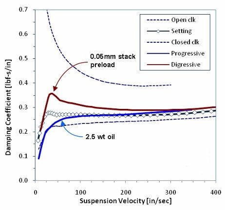

    I can break it down for you if you don't mind.
    Digressive means that the force from the shock decreases as the speed of the shaft increases. The way it works is that there is basically preload on the valve shims inside the shaft. What will that do you may ask? While your driving on the street and taking turns or going slow and hitting small bumps the truck will feel stiffer because it has not quite overcome the preload. This gives the truck better handling characteristics while turning on the street because it's doesn't feel like the truck will roll over as easily (keep in mind this is all relative!). Now when you decide to go hit some bumps at higher speeds (by higher speeds I mean higher shaft speeds, not MPH. So hitting bumps fast and stuff.) the shock will not feel as stiff as you would expect because the digressive set up produces less force at higher speeds. This is good until a certain point because if you hit some stuff really hard, there is a point where the shock won't be able to make enough force to absorb the bump. But that's what tuning is for:D
    Progressive Means the relationship between force and shaft speed is progressively linear. This valving set up tends to feel more like a caddilac at lower shaft speeds (unlike digressive with street car like characteristics) because there is essentially no preload on the valving. At higher speeds the shock will make progressively more force which is usually better for hitting hard stuff because it can make the force you need.
    Summed up:
    Progressive: hitting stuff slower=less force, hitting stuff faster=more force
    Digressive: hitting stuff slower= more force, hitting stuff faster= less force
    Keep in mind if you want a particular set up you mill most likely need to tune to your liking, and also it is all relative.

    ^Nail on the head.
    I set up my track car digressive specifically for the cornering characteristics. It gives better feedback when entering and exiting turns and doesn't have the vauge feeling. But this was also with less than 5" of suspension travel, not 9-11". For a truck...no way. Not my cup of tea. The bigger I go, the more dampening I want.
