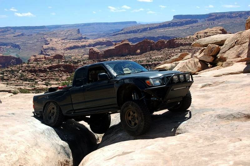

    It happens haha, I know it wasent one of our braided hoses like fox shows in the comparison in the link you posted. Not sure if if it was -8 or -6. I think -8 but I'll have to confirm when I'm at work later.
    Awesome truck btw! Pretty much the same (both stock) as mine but a 1st gen. In the near future I'm gonna go basic mid travel with just extended remote resi coilovers and UCA with a shackle flip in the rear. Eventually I wanna run bypasses in the front and rear though:)
    I got a question about the rear leafs too. I would like the truck to be mostly level after the mid travel kit I mentioned before. I also really would like to get rid of axle wrap as much as possible and I prefer not to do the SUA conversion. Right now my thoughts are the shackle flip(not sure from who, ATO maybe?) longer rear shocks, extended brake lines, deaver j66 pack ( I would like to use the All Pro standard pack but I think it just lifts too much) and I was also considering a bolt on traction bar. Think this would be a good route? I think I would get about 2"-2.5" of lift in the rear from this and have a pretty good ammount of wheel travel.
