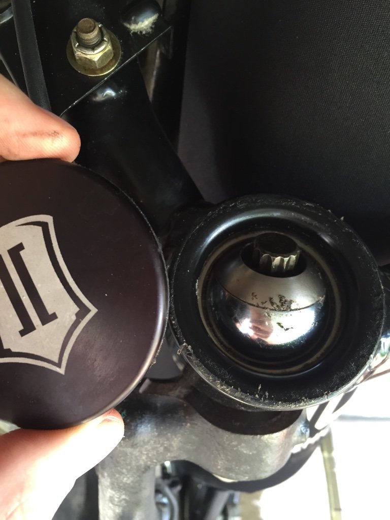

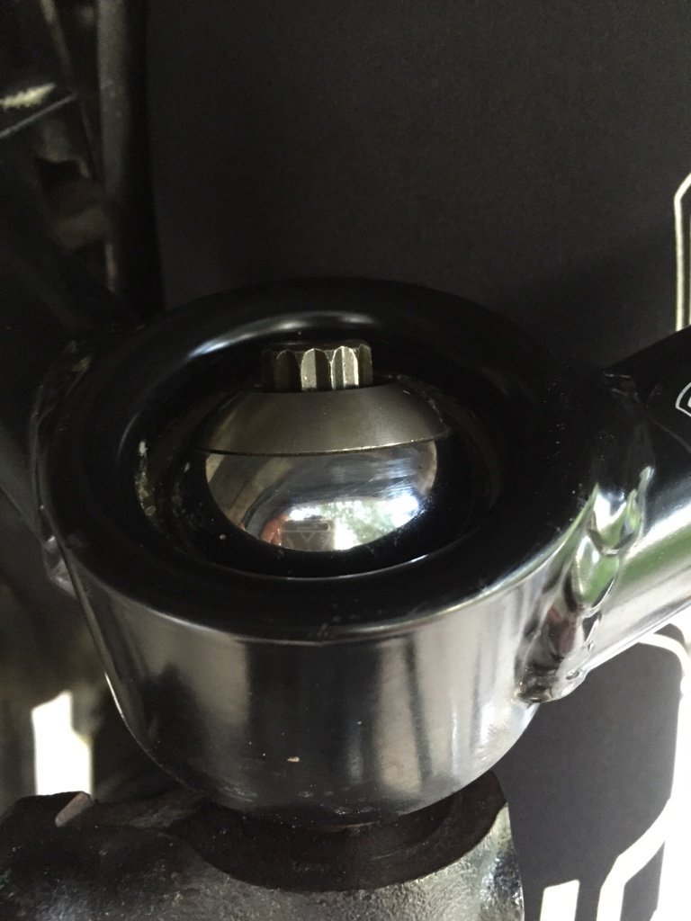

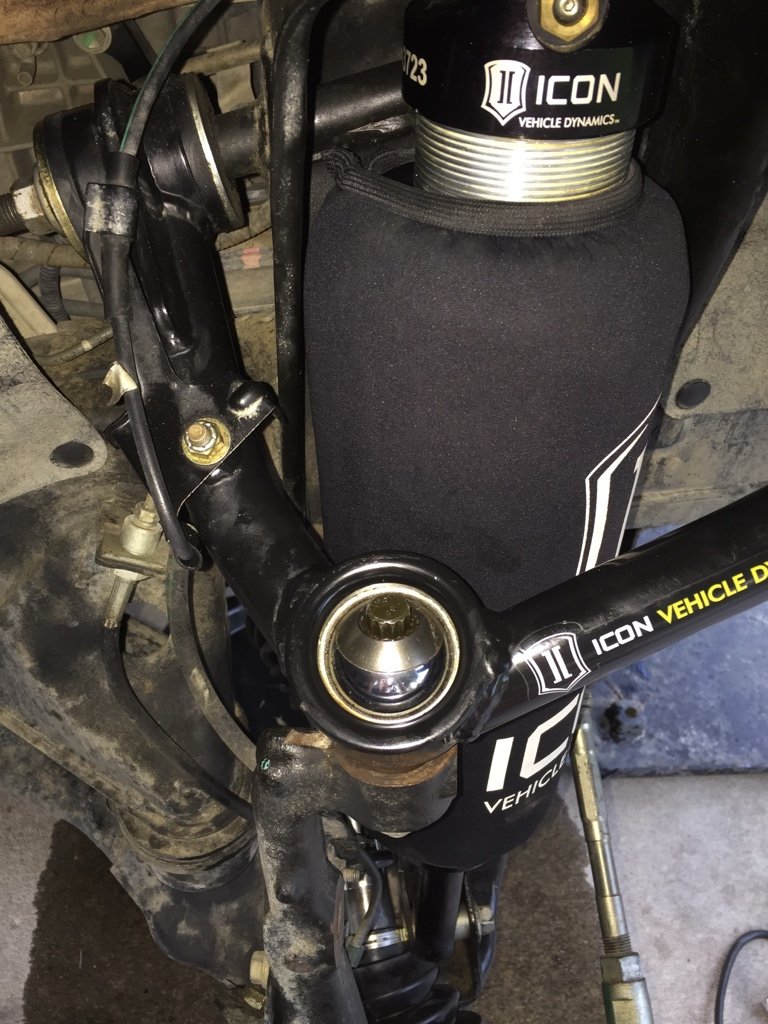

    I will just mention this here too while I am at it and said this in another thread about the icon UCA caps.
    Just an update. I have had my ucas capped for 8-9 months now and took the cap off for the first time on Monday. Before I ever put them on I put 2-3 coats of dri lube on them and let them dry, then I capped them. Anyway they look perfect. Just like the day I put the caps on (thank goodness) I wiped em down and threw several layers of the Tri Flow dri lube again and recapped em.
    Here are pics of taking the cap off:
    fc46f3cc8dba0761ab88721d67316973_aa765b0899e0dae93359abffc63c01815edf5fcb.jpgc57d2e0708f8072c6ce152b55eb436f9_cc0265858f58a7431b96046b1078c3e985ba598b.jpg550175bbe14d803d57f0b497474359f7_d206331ceda9ea9bac97ecd09e7bd7ff20f6f13e.jpg
    So they def work on keeping the dirt and grime out. I was worried I would have a bunch of rust in there like some thought or mentioned but I didn't even though I have driven on the beach many times and wheeled a decent amount over the past 8-9 months so I think they are great :thumbsup:

    Those caps really seem to help. Do you get much squeaking from the uniballs?

    I have had no squeak at all from them yet (knock on wood)
