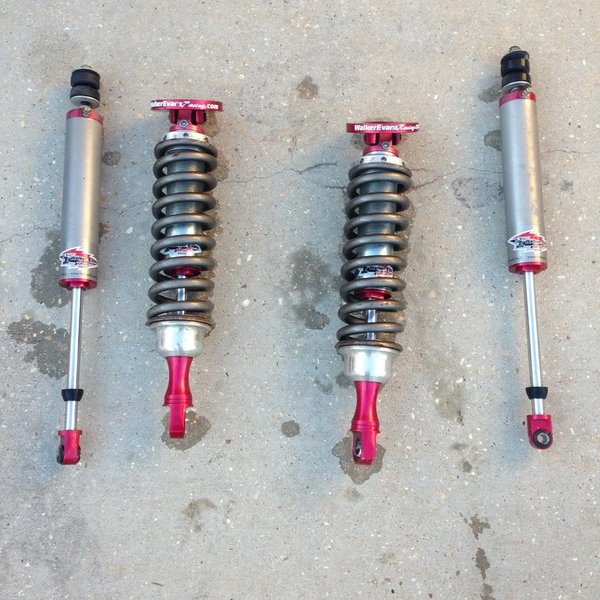

    Don't forget Sway A Way and Walker Evans
