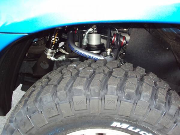

  15. Feb 11, 2012 at 4:32 PM
    #55
    jandrews
    jandrews Hootin' and Hollerin'
    Jun 7, 2009
    #18122
    16,432
    '09 FourDubDee TRD OR
    A-TRUCK, Fat Kid in the Bed, Custom Pinstriping, Ported and Polished Muffler Bearing, Hi-Performance Bed Mat
    You know, one thing that has always bugged me about the resi designs of shocks for these trucks is they never mount in a location with clearance.
    The foxes you posted, for example (and King uses the same method), are going to get creamed by an oversized tire at full stuff, full lock.
    Icon does a little bit better by tilting the reservoir up and shoving it upward in the wheel well:
    But that's still not ideal. What I would like to see is a system that mounts the resis inside the frame in the engine bay. There is space in there; the install would be a little tougher, but still not horrible.
    I wonder if you can mount the fox/king resis on the OPPOSITE side of the brackets? You can't with Icon...there isn't clearance high up behind the fenderwell...but maybe down lower?
