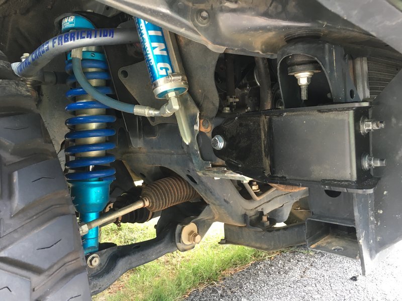

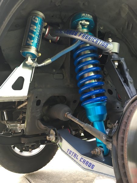

    Total Chaos +2" Long Travel Kit; King/TC 2.5 LT C/O w/ 16"x600; TC/CVJ Extended Axles; TC Spindle Gussets; King 2.5 RR shocks; All-Pro Expendition Leaf Pack; Pelfreybilt Sliders; Anti-Dark LED Hood Light mod; LED map and dome light mod; Bed lights; TRD Cold Air Intake; KB Voodoo Tailgate cap system; HomerTaco Thin Lip "Raptor" grille; sPod SE System w/ LCD Touchscreen; Baja Design OnX6 40"; Baja Design S2; Rigid Industries LED Rock Lights; Front Runner Slimline II Roof Rack; A.R.E. Z Series Camper Shell Projector BHLM Headlights (with custom wiring); Method Racing NVs 17"x 8.5; and Nitto Terra Grappers 265/60/17
    The only reason it's recommended 2" is anything past that your ride quality gets compromised.
    Previous setup:
    Icon 2.5 extended travel coilovers with 13x650 springs
    Icon tubular UCAs
    Stock spindle and LCA
    Present Setup:
    King 2.5 extended travel coilovers with 14x650 springs
    TC UCAs, racing series LCAs (without secondary shock mount), and spindle gussets
    Total lift now over stock is 3.5" and the comfort level is amazing now. I only adjusted them 1.5" over what king sends them as and I spoke with a Kig tech before hand and they recommended not going much further than I did. I'm hoping it doesn't settle too much, it Shouldn't.
    Rear previous setup:
    All-pro expo leaf pack, u-bolt flip kit
    Wheelers off-road super bumps
    1st shocks - icon 2.0 shock with remote reservoir
    2nd shocks - fox 2.0 performance shocks with CD adjustable remote reservoir (for sale, only 400 mile on them. Went with kings in the front so I wanted to buy king for the rear. Foxes were good shocks)
    Present setup:
    All-pro expos, flip kit
    Super bumps
    King 2.5 remote reservoir shocks
    I'm not a fan of AALs. All-Pros are good, but they go 3" over stock and it's hard to match the rears if you want it level. I have some weight in the rear to help out with comfort with the springs. I'm going to upgrade them sometime soon. If you don't plan on having a lot back there go with their progressive springs, and paint it with rust-alium when you get them. Dakars are good, I had them for awhile, they squeak just keep them oiled up. Atlas suspension is whom I'm looking at going with next, custom built leafs.
    Again past 3"-3.5" your talking about drop bracket kits not LT kits. LT kits give you a wider will base and travel, not height. Drop bracket kits give you added truck heigh but not clearance. I'm running a MT setup with a similar affect has a LT kit, minus the wider wheel base, this is all due to the uniball UCAs and LCAs.
    It all depends on where you live too. I live in NC, where we have rocks, woods, and narrow paths. LT kits wouldn't work for me, even though I did consider it. I don't like drop bracket kits, just me. Plus my truck is a daily driver too, so I needed a setup for good low speed travel and highway, plus comfort for my wife.
    If you get the Kings just go 8 full rotation past what they come out of the box and you will be fine. My whole rig has been trial and error, plus getting to know a lot of businesses and other guys with good rigs. You can follow my build page, I going to be updating it soon. I have a lot of stuff on there too. Going to start post informational stuff too.
    I know this was long and I'm sorry everyone, but I hope I answered your question @Boba Fetty. If you have anymore feel free to ask.
