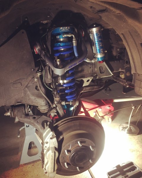

    My hands are pretty beat up lmao and I didn't get to the rear yet... maybe I'll do that today and ditch the super bowl lol but holy moly that was a lot of work. Any tips on what to do with tire rubbing ? I don't really want to get rid of my mud flaps ?

    Here she is put together (minus the rear)
    Someone please tell me the rear leaf pack is easy to do? Lol

    The rear can be a pain. I swapped leaf springs a few times by myself. You will want to use two sets of jack stands. One set for lifting the frame up and the other set for setting the axle on. The hardest part will be aligning the pin hole. Don't be afraid to wack the leafs and axle with a dead blow to help.

    I thought it was pretty easy to just jack up truck by the rear diff with a floor jack and only use jack stands on the frame. Just change out one side at a time and it makes it easier to realign the leaf spring guide pin

    My dads trying to convince me to pay someone to do it lol I'm like f that ! Hold my beer! Hahaha
    Hopefully the rear doesn't take me as long as the front did. (I was held up on the ball joint release from the spindle and then again on the resvoir holder didn't line up quite right)

    What didn't line up right on the res holder? Mine came in Friday and I was expecting the horizontal brackets. DSM assured me these are the right ones though. Will be installing in a couple weeks. Thanks

    I had to loosen the brackets that I guess hold up the front splash/rock guard so that the sway bar could be lower. For some reason I couldn't hold the res bracket flush to the frame cause if I did, the bolts wouldn't go in straight so I had to be able to not have the bracket flush and put bolts in while the bracket was hanging loose if thAt makes sense ... I have Kings. You get kings too?

    watching a YouTube video and see the Rear diff being dropped down, I became discouraged lol
