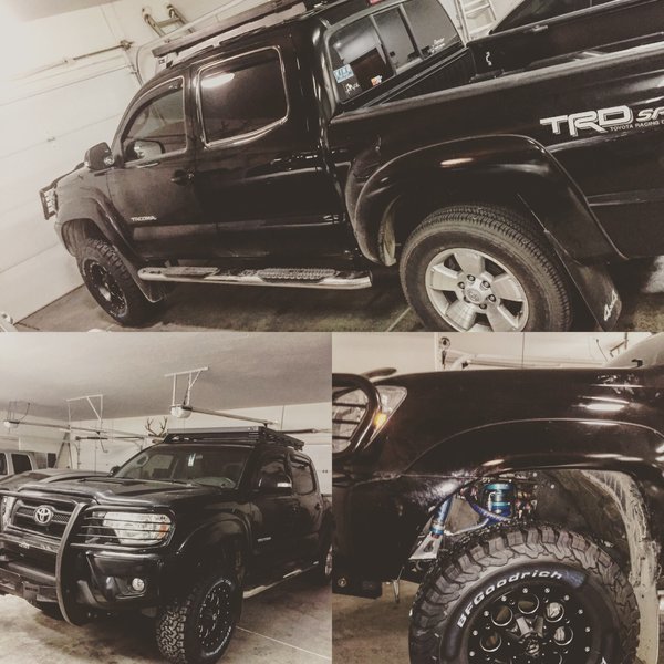

    Yup, can't wait to install with my new wheels. Just waiting a bit so the wheels don't see as much salt this year. Tried them on but took em off.IMG_20170122_144036871_HDR.jpg
    Jon27 and roadrashchic[QUOTED] like this.
