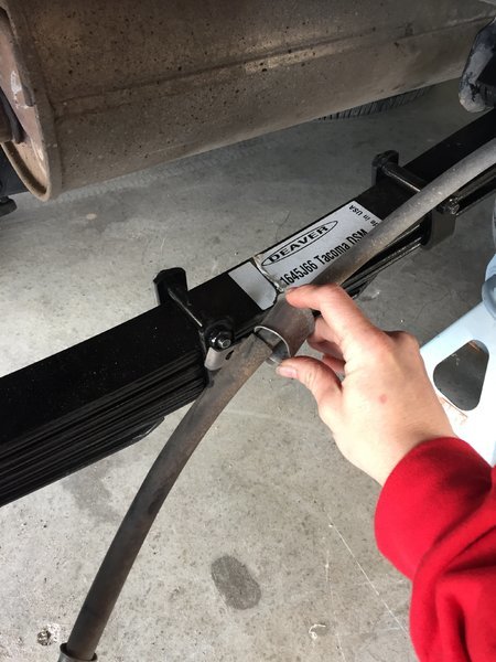

    I mounted on that bolt next to your hand on the leaf springs
    roadrashchic[QUOTED] likes this.

    Looking good Jessica :thumbsup:

    Remove them or trim them back :thumbsup:

    Zip tie

    I trimmed them... still rubbed... took them all the way off... and I thought I solved it until I took a sharp turn up hill Do i have to trim the wheel well too?! Wtf! I wonder if I should've adjusted the coilovers higher lol

    Depends on your tire size? You could do the CMC aka cab mount chop mod to fix the rubbing.

    285/75R16

    Yeah with 285 you might have to do the CMC mod. You can run a wheel spacer but you'll still rub the fenders when you hit a bump on road or off road.

    You're gonna rub the cab mount with 285s, pretty much guaranteed. Maybe not sitting still in your driveway, but reversing at full lock, and the first time you hit a bump turning, youll hear that magical sound that makes you grit your teeth

    I don't think I could of explained that any better myself. For the traditional 2-3" lift set up, 285's with or without spacers WILL need a chop!
