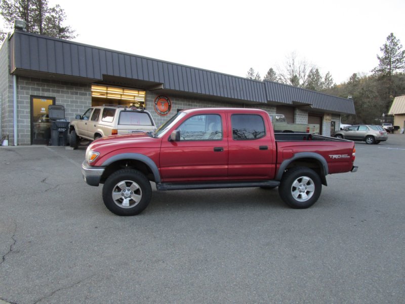

    Bro lean is gone. I now have a natural rake thanks to Mike at Mike's Custom Toys. Fox and Deavers!!!suspension.jpg
    Mike said the Deavers will settle about a half inch in 500 Miles. And the Fox Coil-overs will settle about a quarter of an inch.
    Ended up putting the Fox 2.5 Factory series coil overs on. I told Mike I would be adding a winch soon. He said the 2.5 would be better suited for the added weight.
    After an alignment I hit the road to Eugene, OR. last night. All I can say is I am pleased with the results. My Taco is actually fun to drive now.
