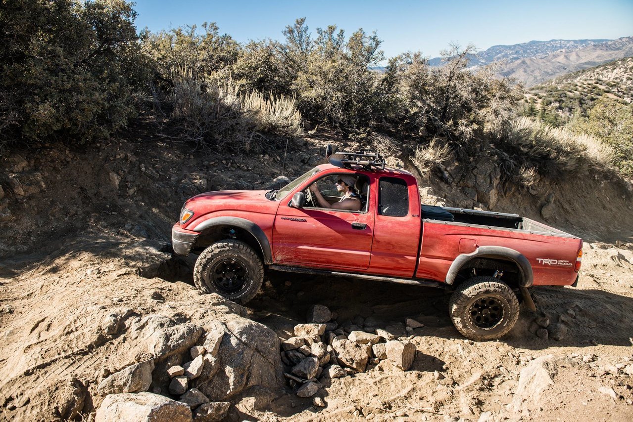

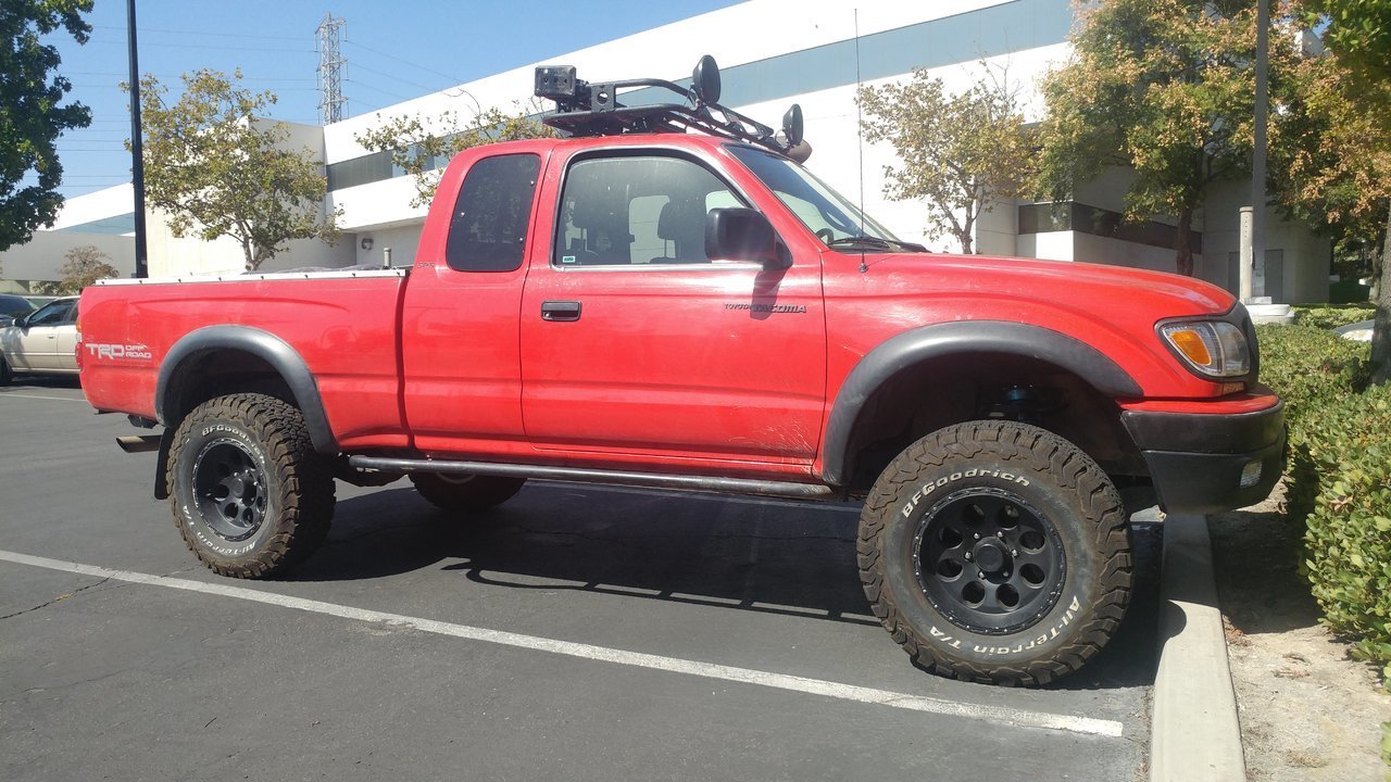

    Yeah I went ahead and pulled the trigger on them, they arrived yesterday and I slapped them on my truck last night. Haven't really gotten to test them out yet other than driving round town where it does feel a bit better all around, but I'll be doing a trail run over the weekend so I'll really get to see how it feels then. The Kings up front are surprisingly stiff but I figure it's likely due to the 600lb coils and with no added weight on top of them, yet (1st gen stock coils are 490lb).

    lets see some posts of your stance

    Wheeled the setup on Miller Jeep Trail last weekend, really happy with it though I might knock the preload on the Kings down a little bit. Between that and the 600lb coils on them with no added front end weight, they were riding a little harsher than I'd like. It was fun though being able to ride the trails faster without having to worry about blowing out my 5100s, lol.
