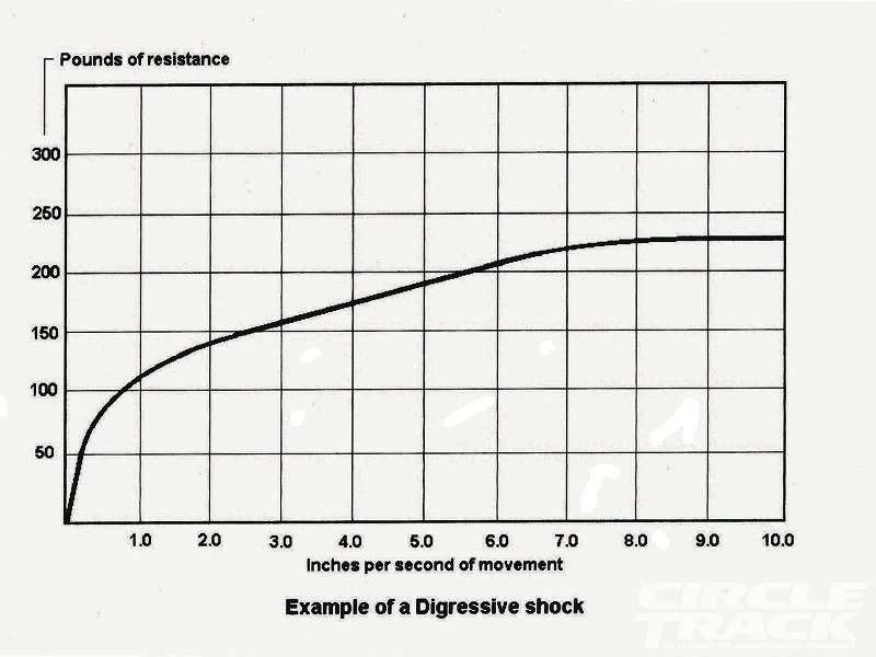

    Just wanted to touch on a few things for everyone that are a little off from what is coming out of this thread....ICON has a "digressive rebound piston" and it's not just pre-loaded valving shims. A digressive piston has a completely different flow characteristic then that of a linear piston. If you dyno a linear piston with no valving at all, and compare that to a digressive piston, you can see a difference at high speeds.
    You are correct about the vehicles being different, 4Door 4WD V6 will ride different then a Single cab 2WD 4Cyl (just an example). However the ride quality is still within our acceptable range of variation for the different weights of those vehicles. Take for example the Nissan Frontier, we (ICON) make a light and heavy valving option because the weight difference between certain factory equipped vehicles is drastic enough to warrant a different shock tuning all together. We cannot account for EVERYTHING a customer can and/or will do to their individual vehicle. These are a production off the shelf product we do not currently produce multiple options for every vehicle on the production level. So to combat that we offer 2 things, one is a shock tuning service to accommodate those specific customers needs. We can re-tune a shock to work with modifications you make at any time whether you decide to make changes upfront or down the road. When a customers requirements fall outside the range of our off the shelf shock, we also have the second option and use a custom build approach. We have sheets that we fill out that can create any combo and valving spec with all the many options of parts we can use to accommodate the needs. We do this all the time for individuals though our dealers. Heck some of them even re-order the same thing often because their customer base has the need for it on more than one persons vehicle.
    On to the CDC......
    The CDC Valve does restrict oil into the reservoir, but in a CDC equipped shock we (ICON) recalibrate the main piston to compensate for the additional resistance added by the CDCV. Otherwise, just adding a CDCV would make the shock drastically stiffer. CDCV’s don’t change valving, CDCV’s change the amount of force created by the shock. Ultimately the vehicle doesn’t know if the resistance in the shock to absorb a hit/bump is created from the shocks size, the piston, the valving or the CDCV. All the truck feels is a dampening effect from the shock regardless of it’s origin. We (ICON) make sure that the coilovers are correctly calibrated to absorb a shock input/hit with a well-defined output/resistance from the coilovers to accommodate that size of hit. Yes, as a matter of fact there is a second DIGRESSIVE piston and valving in the CDCV. We have different CDCV’s for different applications, 7/8” shafts, 1” Shafts, IFS applications, 1:1 or straight axle applications and the list goes on. We DO NOT have 1 CDCV. We have several configurations to accommodate for any and all vehicle specific applications we make shocks for. Yes you are going to see marketing terms or marketing hype used as it was said and this is so you the consumer looks at it or or way long enough to find out some info. I have kids and you know as well as I do if you walk in the grocery store the house cereal brand is not going to get the time of day vs the cool looking transformers triple throw me down box right!!! Look we want you to look our way and find out more about it, find out that we are not just doing what all the other guys are doing. We took a different approach to this and it was well thought out prior to even deciding to add it to our line. With this said anyone is welcome to come down and learn about our shocks. We welcome the opportunity to educate you about the products ICON is making. We are working hard right now to release the CDC Valve for ICON shocks formally and should have this out in the next few weeks or so. We want to do it right and have the correct display of information along with video to help people understand what we are doing. We want to eliminate the guessing and provide you the facts your after.

    See now this is the kind of information I prefer to read!
    So for the digressive side of the piston, is it stepped or dished or...something else?
    Do you have a force/velocity graph of your piston without valving?
    Fitting with the digressive curve, what IPS does the shock start to get stiffer at a slower rate?
    Do you have a video, or cutaway picture, or even a picture of the CDC components and the second piston that you can share?

    As mentioned in the post prior to this, we are assembling graphing examples, video, and I am going to request a cut away as well as that does make sense.
    Is there something specific you have in mind so I can relay that to the team? We are more than willing to provide the example if it is realistic. That is why I am here, to be with one with you and get what your looking for so you make a good decision about our product. We are very open minded and want to provide the information the consumer is looking for when factoring ICON suspension and shocks absorbers in their decision. Can we open our computers and give you drawings, and every last detail, probably not. But I know I can get you enough to suffice our desires for sure. I def was talking in general on the marketing hype deal and it was a broad scoped comment. We call this the CDC Compression Damping Control Valve, well because that it what it really does. This was thought out and we took a different approach. We did not just throw in a valve that allows the shock to get stiffer, it has to make sense. So we set the standard valving curve to about number 4 so you can actually soften compression or stiffen compression over our standard valving in the regular coilover for that model. We did each and every remote reservoir application one by one.
    Let me know your ideas and we will work on some real life examples if there is a way. If you need give me a call at the shop and we can chat about it.

    I don't think anything I asked for is going to step on you making a dime. It's all basic shock 101 info. It's not like I asked for the valving specs on the last race the ICON truck ran. All my questions could be answered by opening the shock up and/or dyno testing it.
    I never said ICON's can't be rebuilt at home. I asked about us DIYers. I can pull an exploded view of Fox or King in a hot second in the event I bump my table, drop parts, or mix up the order of the guts, not so much for ICONs. And it's not like I can just make a quick call and talk to whoever on a Friday at midnight when I'm trying to finish prepping my rig.
    And cmon...you guys do have that hypodermic needle charge port on at least some of the ICONs I've seen, so it's not entirely like rebuilding any other shock with a schrader. One more one-off tool to buy and throw in the toolbox.
    For those of us that actually have a little experience with shocks, if I have to make an educated decision about what to buy, I'm going to buy the one where I can get the most information, least trouble, and the most support on. Little things like an exploded view and expanded/collapsed lengths are a no brainer. All I'm really asking is to be a little more forthcoming with some of the specifics.

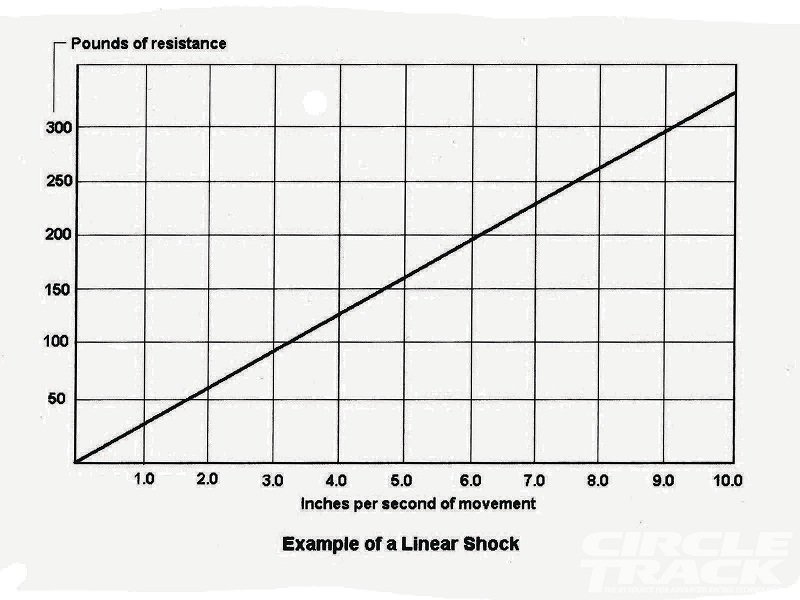

    The graphs are oversimplified. A good basic idea, but not exactly correct.
    The linear graph is not so much a piston design with shims stacked onto the piston. That graph is based more on a piston with a single port and no shims.
    Once you begin stacking shims, the damping curves are altered.
    ICON is posting about two different concepts. A digressive piston, upon which the shims are placed and a linear piston.
    Depending upon how the shims are stacked, crossovered, or stop plated will determine how the shock performs.
    So far, very little has been offered other than call and talk with Dylan.
    In regards to the compression adjuster, unless Icon has something new and revolutionary, the compression adjuster is in simple terms going to be a freebleed adjustable metering port, in parallel with a shim stack. Tuning of the compression adjuster is important to better match the main piston and stacks, but often can be a more general setting since the compression adjuster sees flows a fraction of the main piston.
    I would suspect that any shock cutaway from Icon is pretty typical of any other high performance shock.
    These are not bypass style shocks, so they closely are related to the rear shock on almost all modern high performance motorcycles.
    I agree, nothing posted to date and nothing short of specific valve stacks is anything more than basic gas shock 101.
