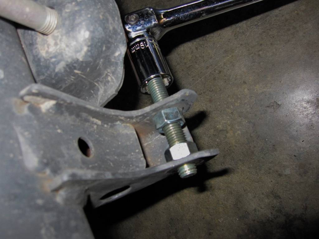

    When you are ready to install your shocks, get a fully threaded bolt, preferably NF, put some molylube on it, run it through two nuts inside of the mount and use the nuts to jack the mount open. It's really tight.
    Or just put the head of the bolt on the inside with just one nut, but it's easier with two.

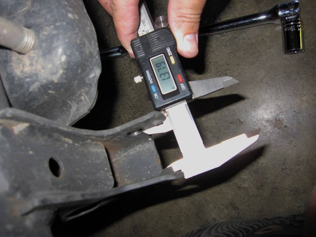

    Here are some pics. I used a breaker bar to hold the bolt, then cranked on one of the nuts with a wrench. I measured the shock bushing with my cheapy caliper(all my starrett and mitutoyos are at work), and got 1.375"
    You have to open it up way past that because it will spring back. I opened it up to around 1.500"
    After releasing the bolt, it sprang back down to 1.379" in the front. It was still a little small towards the back closer to the welds, but the shock still slipped right in.
    Hope this helps somebody :)
