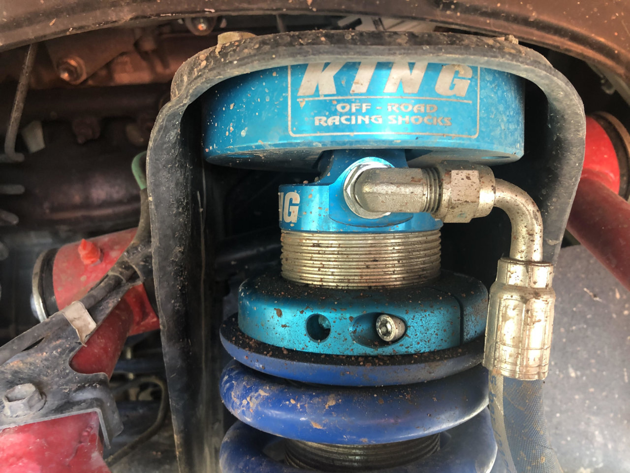

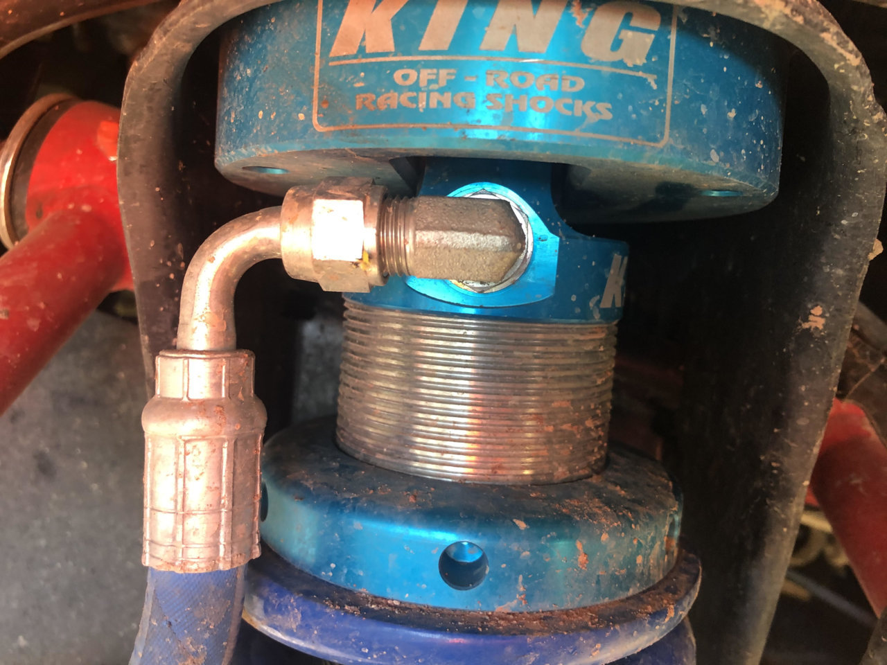

    I attached some pictures to show my preload. First is driver and second is passenger.
