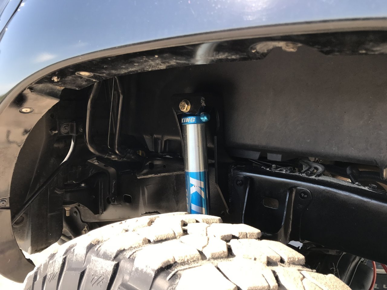

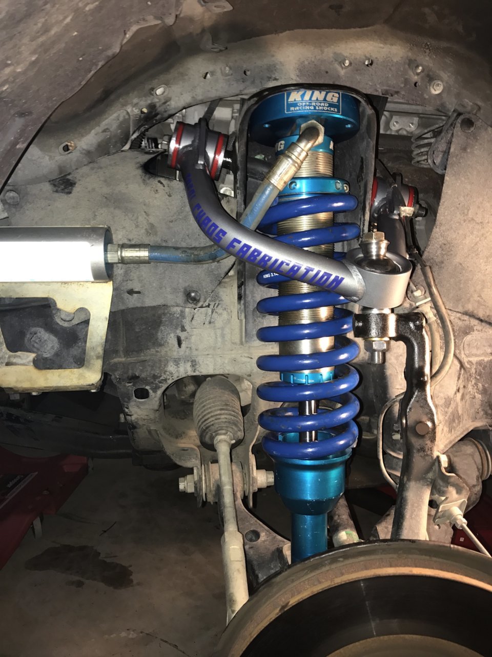

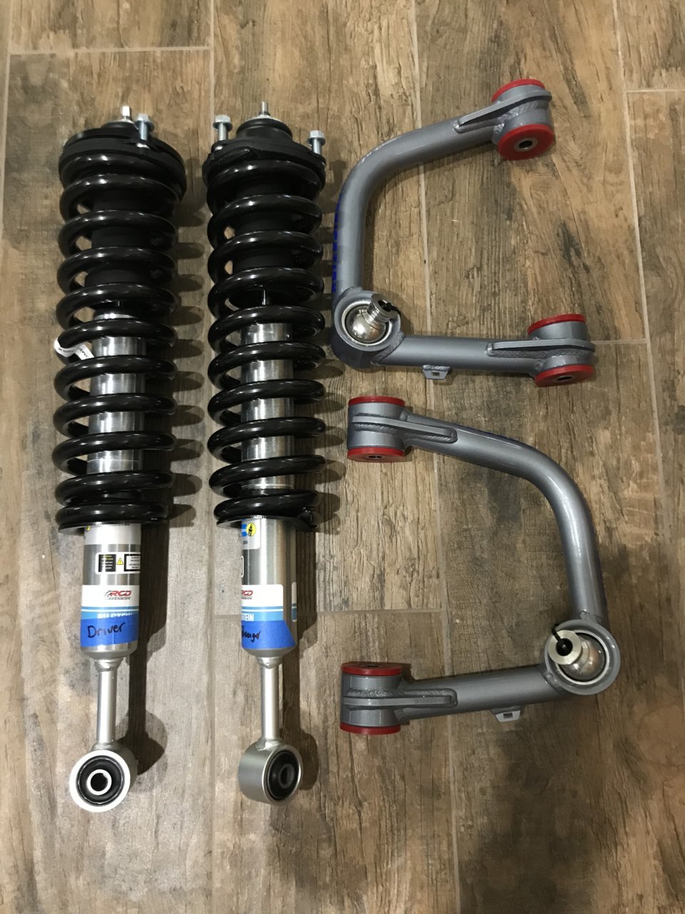

    I had a long distance relative ride in my truck for the first time over the weekend and without prompting the discussion he went on and on about how well the truck rode and handled the bumps. He said it rode smooth as glass.
    When I had my shocks rebuilt by DSM I told them I do mostly street and when it’s off road it’s slow rocky trails, they said they knew exactly what to do and I’m really happy with it. I’m using 700lb springs, Pelfreybilt full hoop steel bumper with winch, skids, sliders, HC rear and tire carrier, and an occasional topper. I’m on 255’s that I usually keep at 55psi. At 35psi they are smother but fuel economy and tire wear goes south.
    Preload looks a bit high but I don’t believe you have too much. I don’t think your springs are too stiff or your tire pressure is too high either. From the pictures, I cannot see that anything is installed incorrectly. This leaves bad valving or expecting too much. Expectations are subjective, obviously, but if you’re saying you feel every inch of a pothole I’m more inclined to believe the shock is wrong. It might seem unlikely but stranger things have happened. I’d say call Downsouth Motorsports and talk to them about it. It would be really obnoxious to have to get them revalved but that’s where I would start.
    edit: added pics
