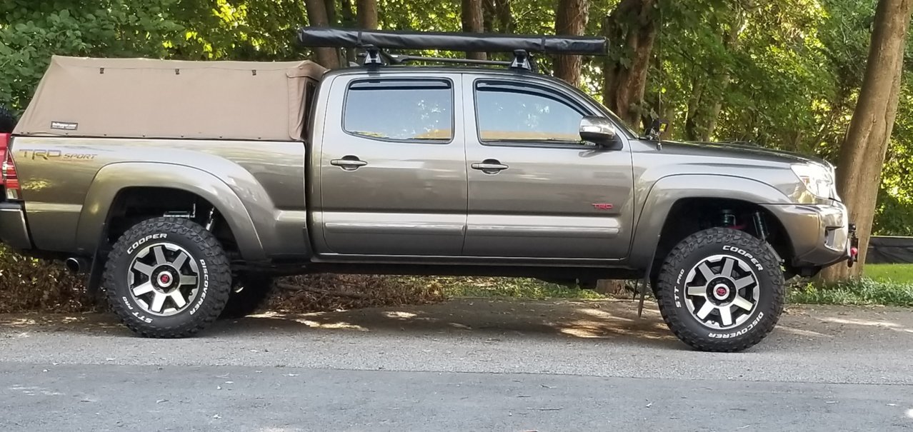

    Front and rear Kings set at 2.5 with 650 springs. Driver's side cranked enough to adjust for lean. Relentless Fab Lower Stingray Winch Mount Bumper and Smittybilt X20 Wireless Winch. Sits nice and level.
