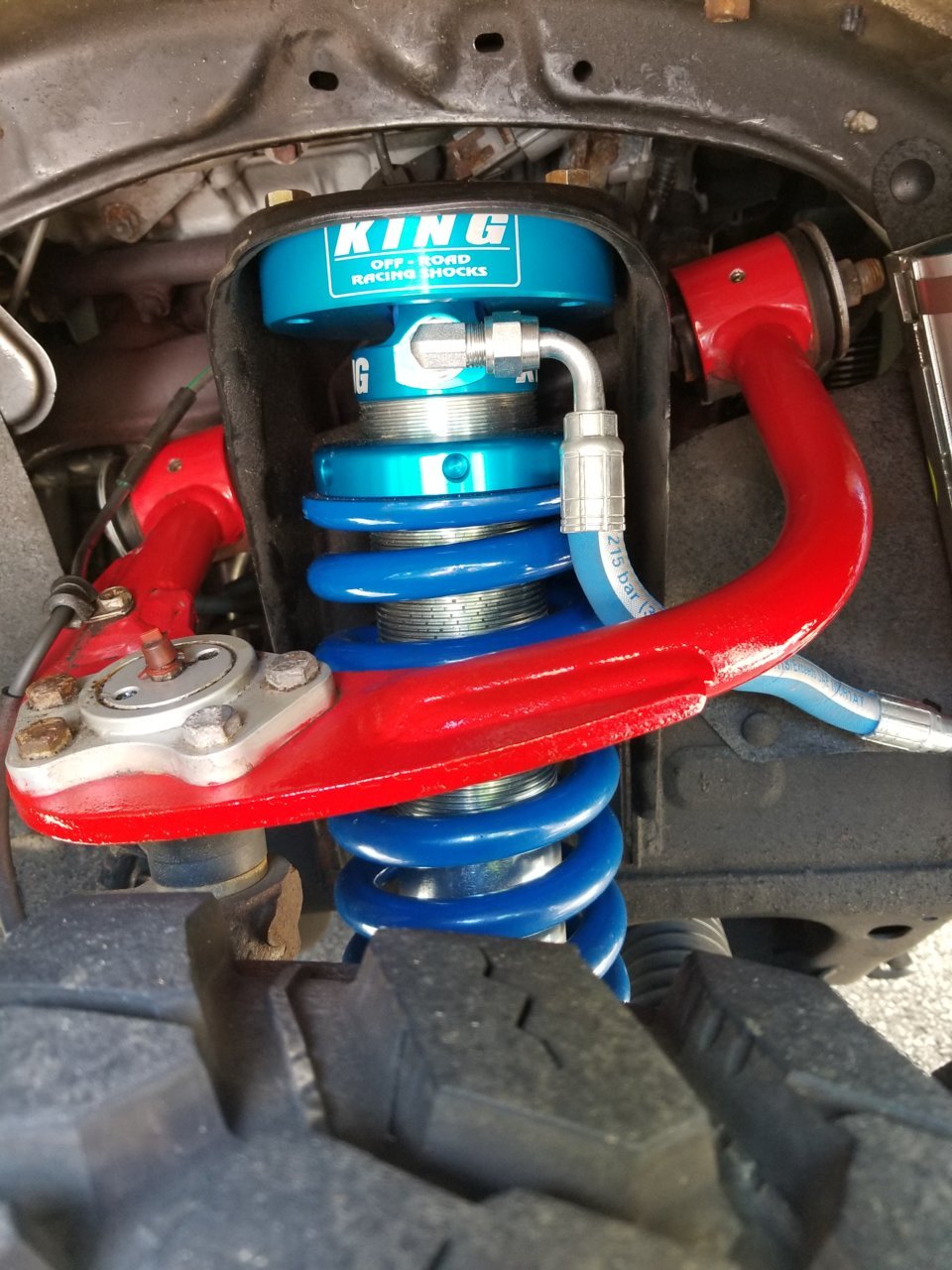

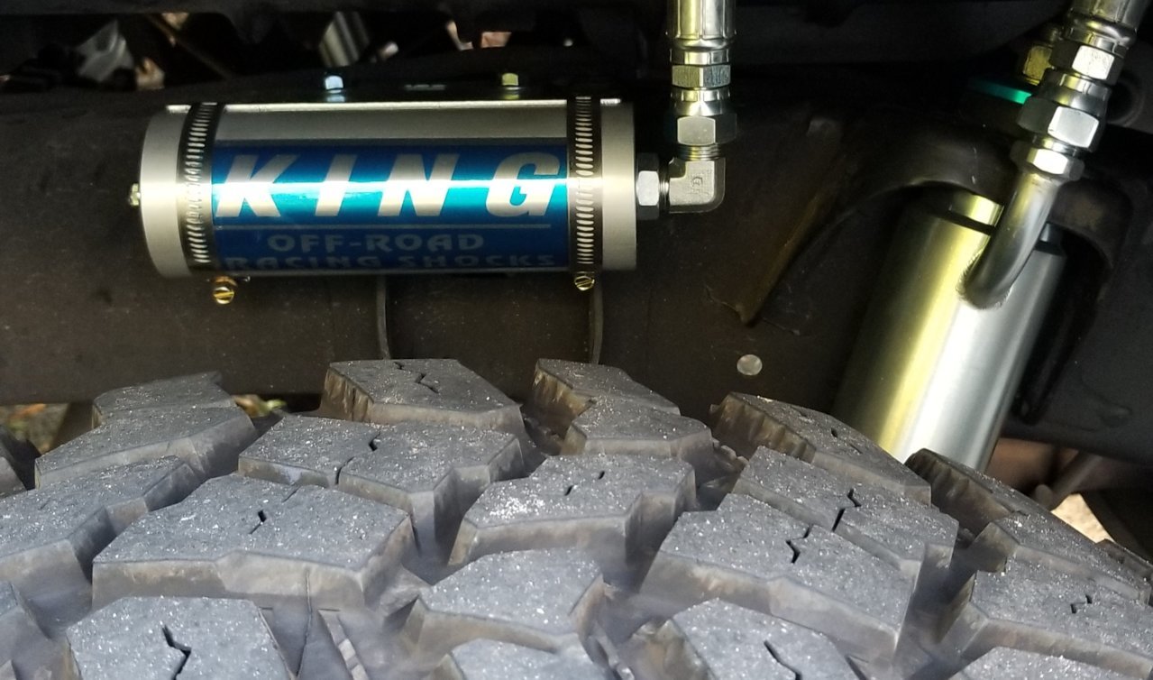

    Kings, running a full set and they were amazing at dunes this weekend.
