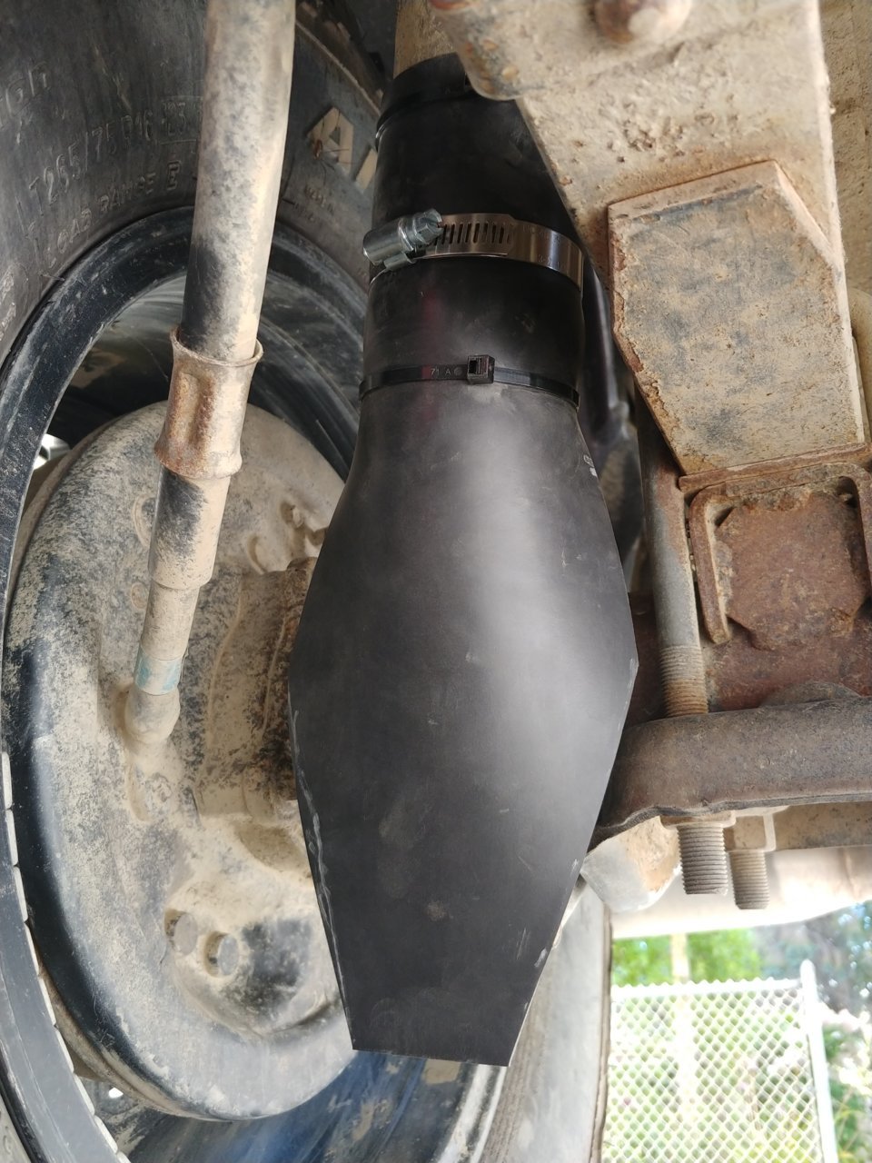

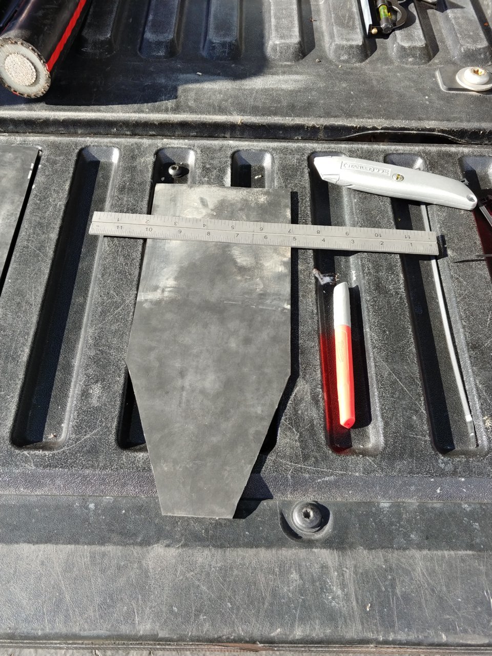

    it’s stiff enough to stay in place but can flex If there is contact once the shock compress.
    This is the product. I just cut it to 2” wide
    https://www.mcmaster.com/86335K246/

    Nice. I ended up using a Buna-N rubber. A bit more expensive but its resistant to just about every oil and grease you might find on a truck, even gas.
    Cut to fit and pop it on. Havent done any off road trips with it yet, but no issues on the highway so far
    https://www.mcmaster.com/1861T24/

    Yeah those boots are garage in any climate that gets wet, let alone road salt. Thats why I made the rubber guard thing

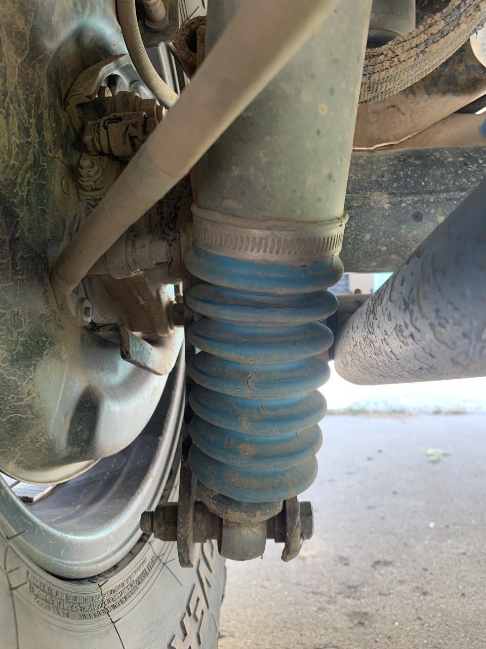

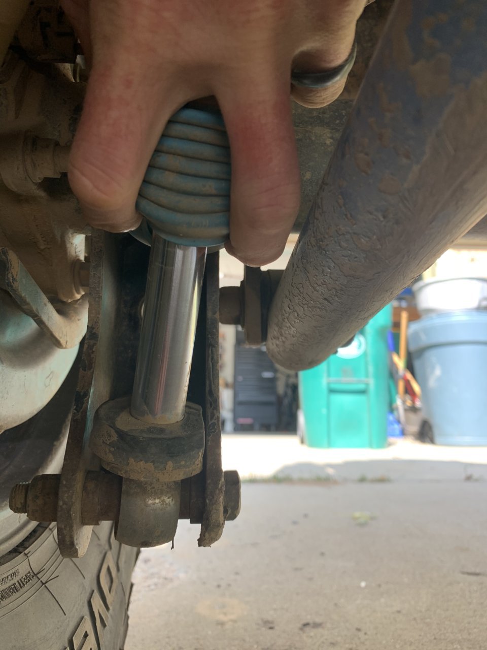

    Been running the Daystars for 4 years, cut them so the aren't bunched up and hanging loose at ride height. They see plenty of water and mud and lots of high speed rocks, especially hanging down super low on my 4Runner. The shafts still look new, never rinsed them out. I have had to replace them as they get torn up stuffing them with the shock fully compressed, you can see one of the bites in the pics. But for how cheap they are, no brainer for me, would recommend.
