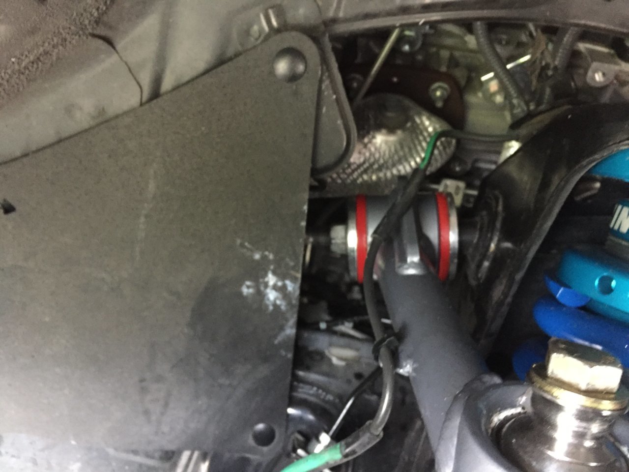

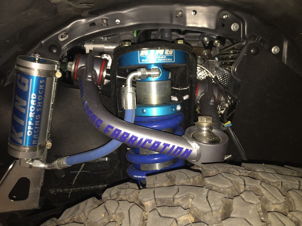

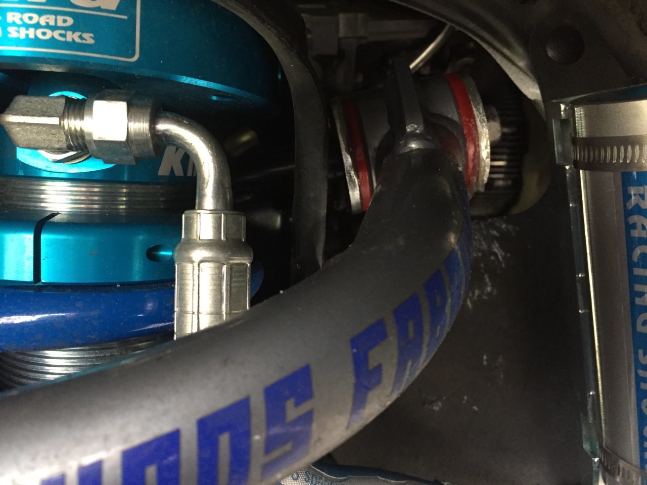

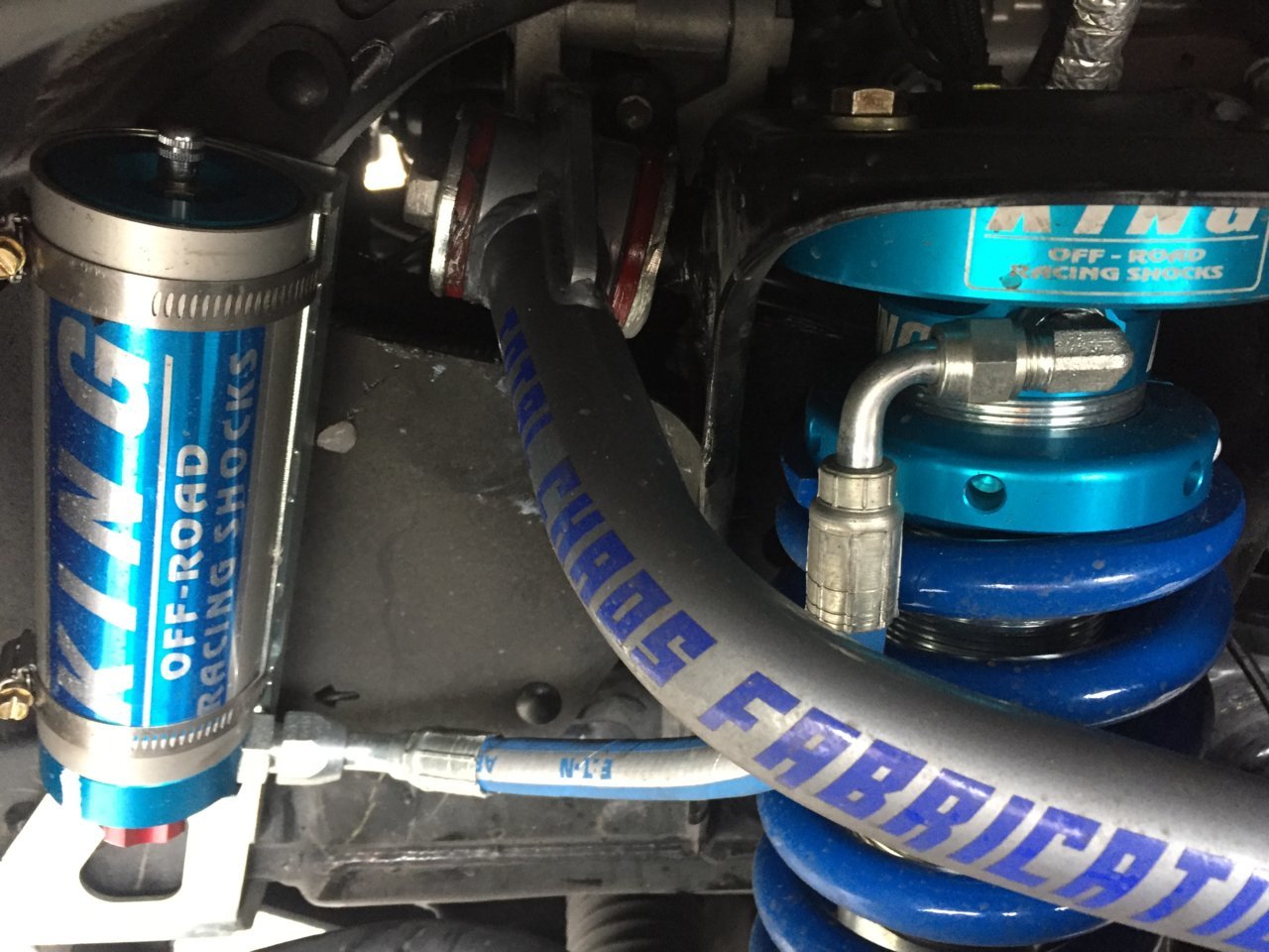

    Have any pictures of your setup? Happy to take a look and let you know if anything looks out of the norm.
    Sometimes it takes a minute for the grease to work its way down the intended path. Driving for a bit will allow everything to break in. Let us know if the noise continues. Happy to figure out a solution

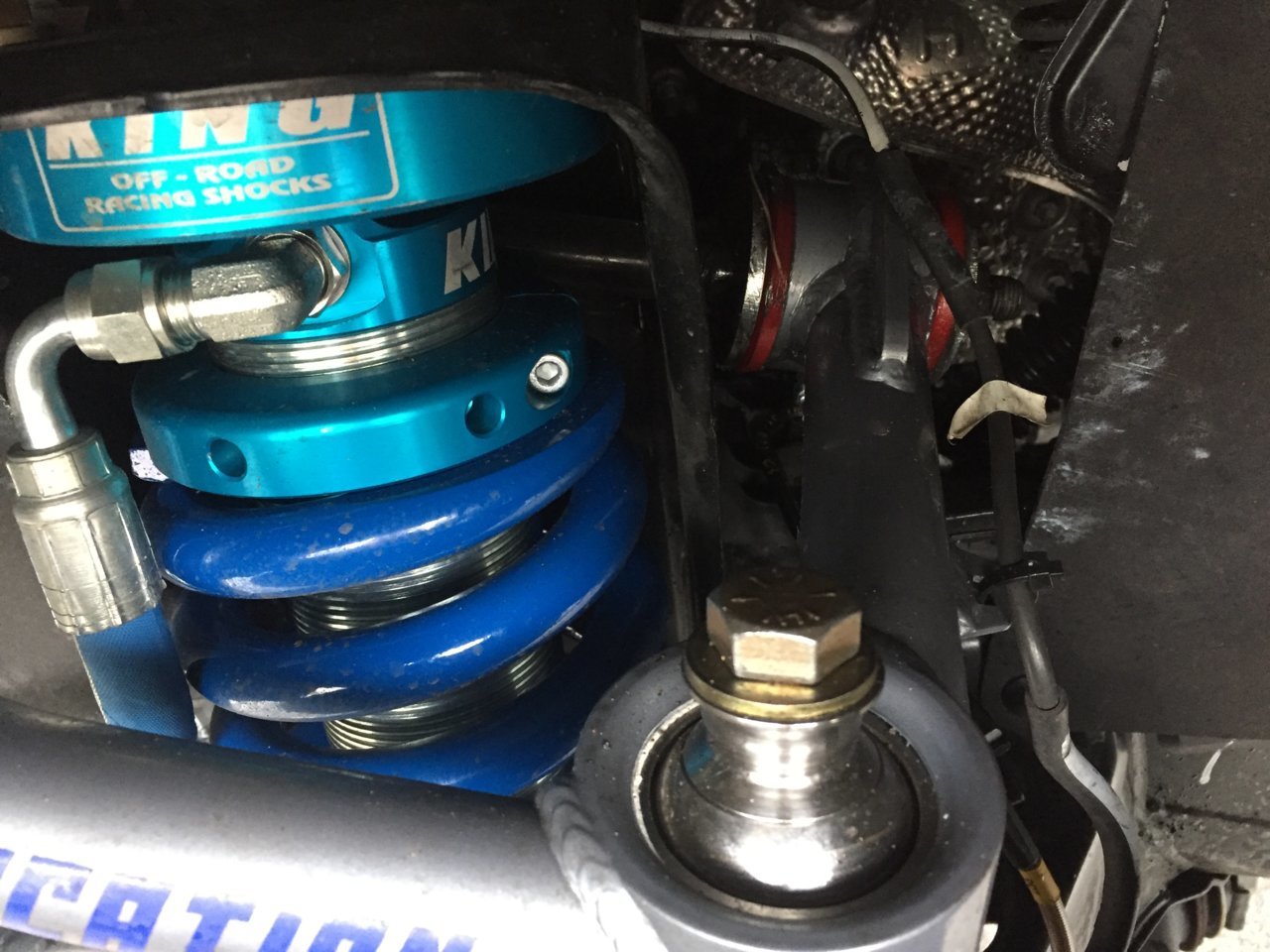

    TUj3F1OL2FU4cM5kqJwWO6fhVEK9w-W0pOe97WXt_3e519fe251e63f25e39b809e31235f24e367a4e6.jpg
    5vmZICRSabw857idLQs7nrxrX1OLxr-8nqGjnORy_39aeffe9f4aa945b4115d7880b4b77e2a40a279d.jpg

    The first two pics are drivers side the other two passenger side97672EE2-9448-4CB6-8BFD-17EA031CD841.jpg280D0B9A-00C8-4549-807B-50F8CE610EAC.jpgE1D18872-20DD-43B8-A26F-C63D3471CD56.jpg46974748-5264-4D36-B3B9-81587E834CA7.jpg
