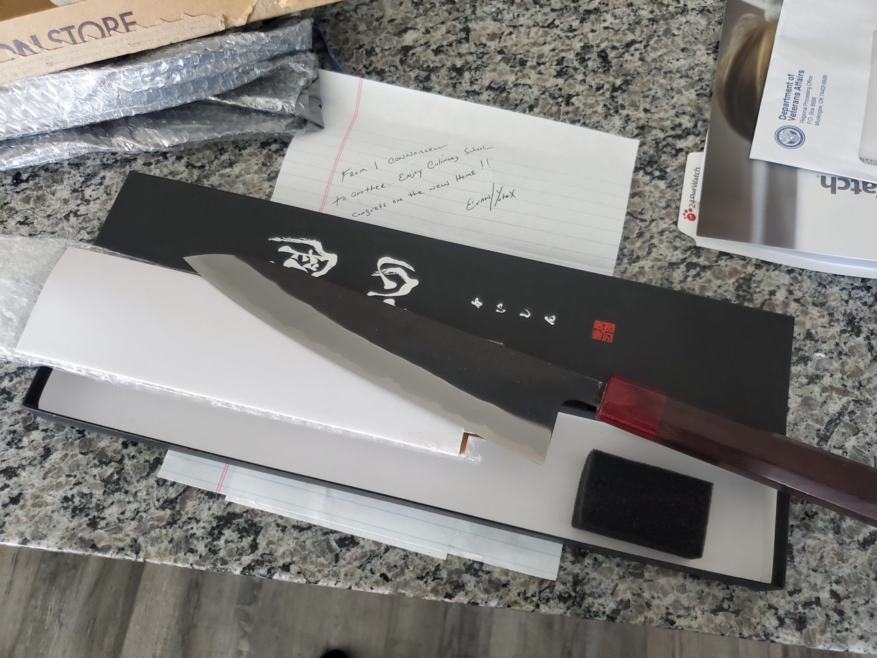

    Hoping this is the right area to post my inquiry.
    I'm finishing up the first module at Culinary School, only to start in the kitchen next week!
    With that said, I'd like to hear what others are using when sharpening and maintaining their knives. More specifically, white steel (uncoated) knives!
    I wish to provide the best care and maintenance to a beautiful knife I received as a housewarming/culinary school gift from @Yota X (stoked to use it!)
    I did find an awesome video that goes very in-depth with sharpening which I'll post at the bottom.
    Just curious to see how many on here are using a knife made of white steel, and what stones you prefer to use?
    https://youtu.be/k8Ddbit_FWg

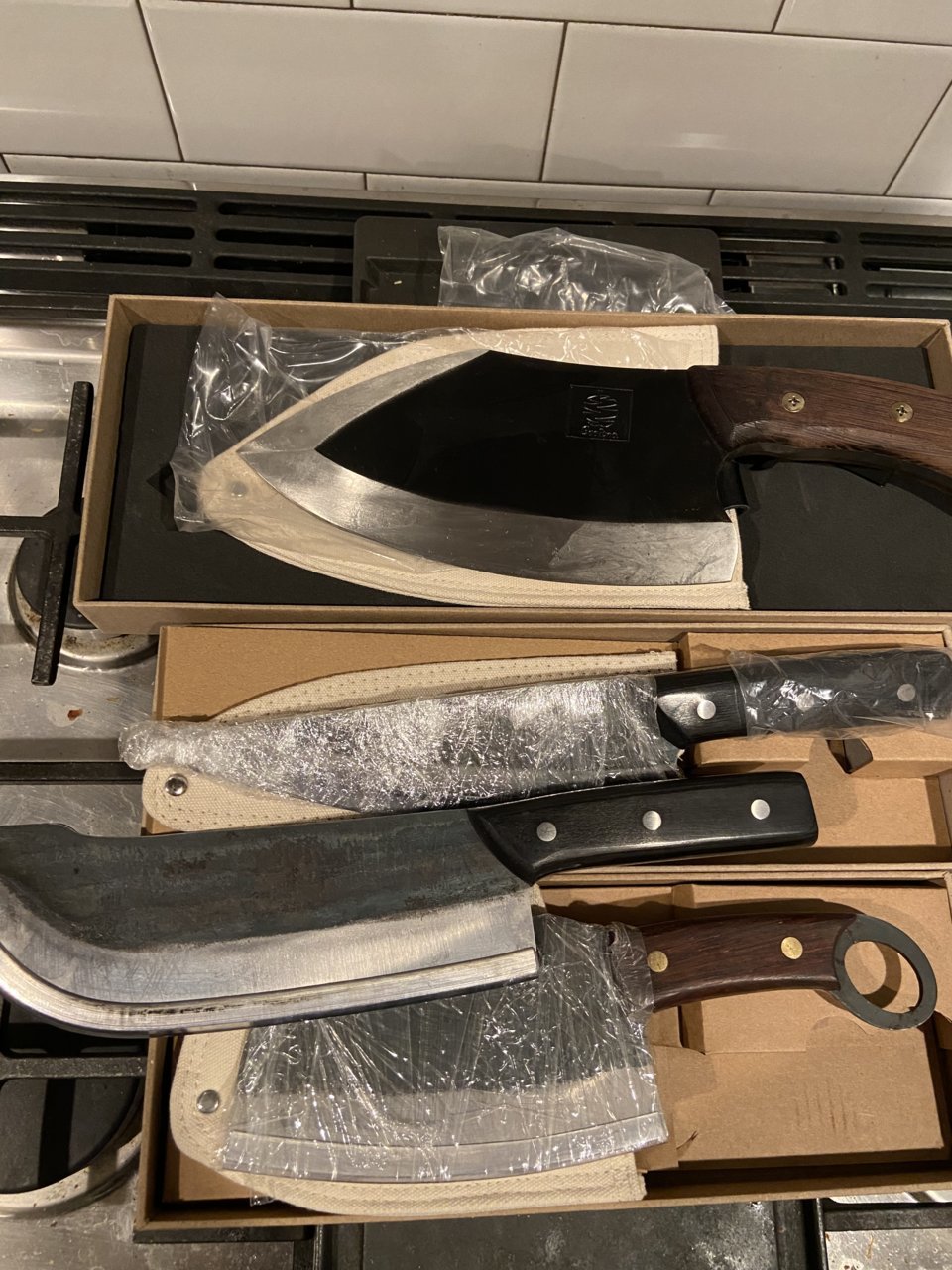

    That thing is so badass. So funny you posted that cause I just got some new ones myself. Not as quality as that one but super cool carbon steel.

    is the OP knife single bevel?
    anything but a whetstone is not gonna work to keep the original bevel.
    do they teach knife stuff at culinary school? how to keep them sharp, etc?
